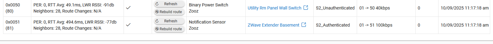

I have one Z-Wave node that is on the outer limits of signal strength. It is not a LR capable device (older ZEN21). Its node number is x50, 80 and has a -91dB RSSI. It is the weakest node in my network (although I have a few at -88, -89 as well). See table below...
I put in a ZAC38 repeater in between the device and the hub. The repeater is shown in node x51, 81. After doing a rebuild I was surprised that a hopped route didn't appear in the route entry for node x50, I thought I would get 01 -> 51 -> 50 as the new entry.
Isn't -91dB a weak signal that should be trying to find a hopped route rather than direct?

Not sure yet, some inconsistencies but jury still out. I just noticed the RSSI being very low and found that odd. I should have mentioned its a C8-Pro so has external antennas.
