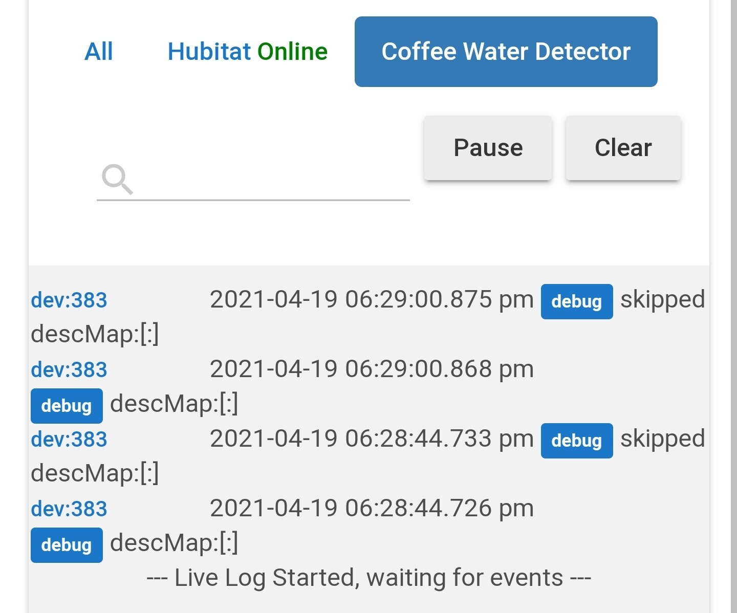

So i got it, but when it joins my network, it showed up as a button. I can't tell the difference between a press event in the log (which i assume is what is happening when the sensor gets wet):
What am i looking for? Lol
Are you talking about the Xiaomi Leak sensor? If so, you need to install a valid driver for it.
There are several Xiaomi Aqara leak sensor drivers floating around here. Here's an old one, but it works fine. I'm still using it. No problems or errors. No drops at all from the Aqara Leak sensors when joined directly to HE.
