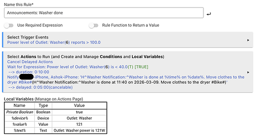

I don't know about that. I have a very simple rule that has never failed with my washing machine. Here's what it looks like:
This is correct. I think I watched power usage for a few wash cycles before determining power use conditions that were a catch-all for the washer. I have similar rule for the dryer - also based solely on power consumption.

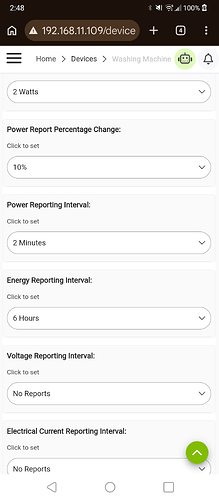

I have a zooz zen 15 appliance switch with power monitoring and a lg top load washer. ss mentioned unwill need to watch your usage and adjust for your washer but this is my rule that always works and my zooz settings .
