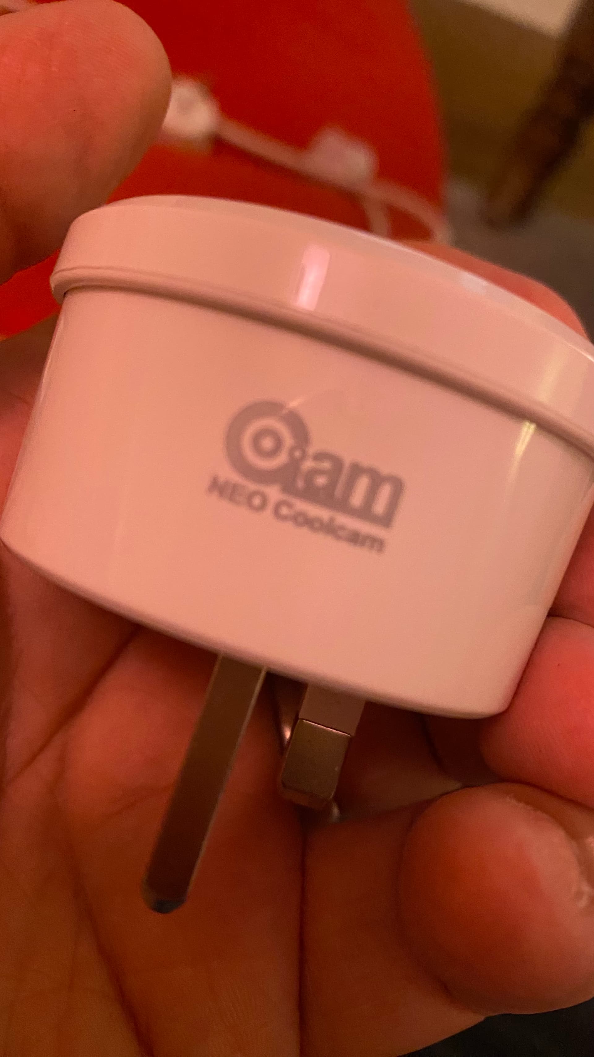

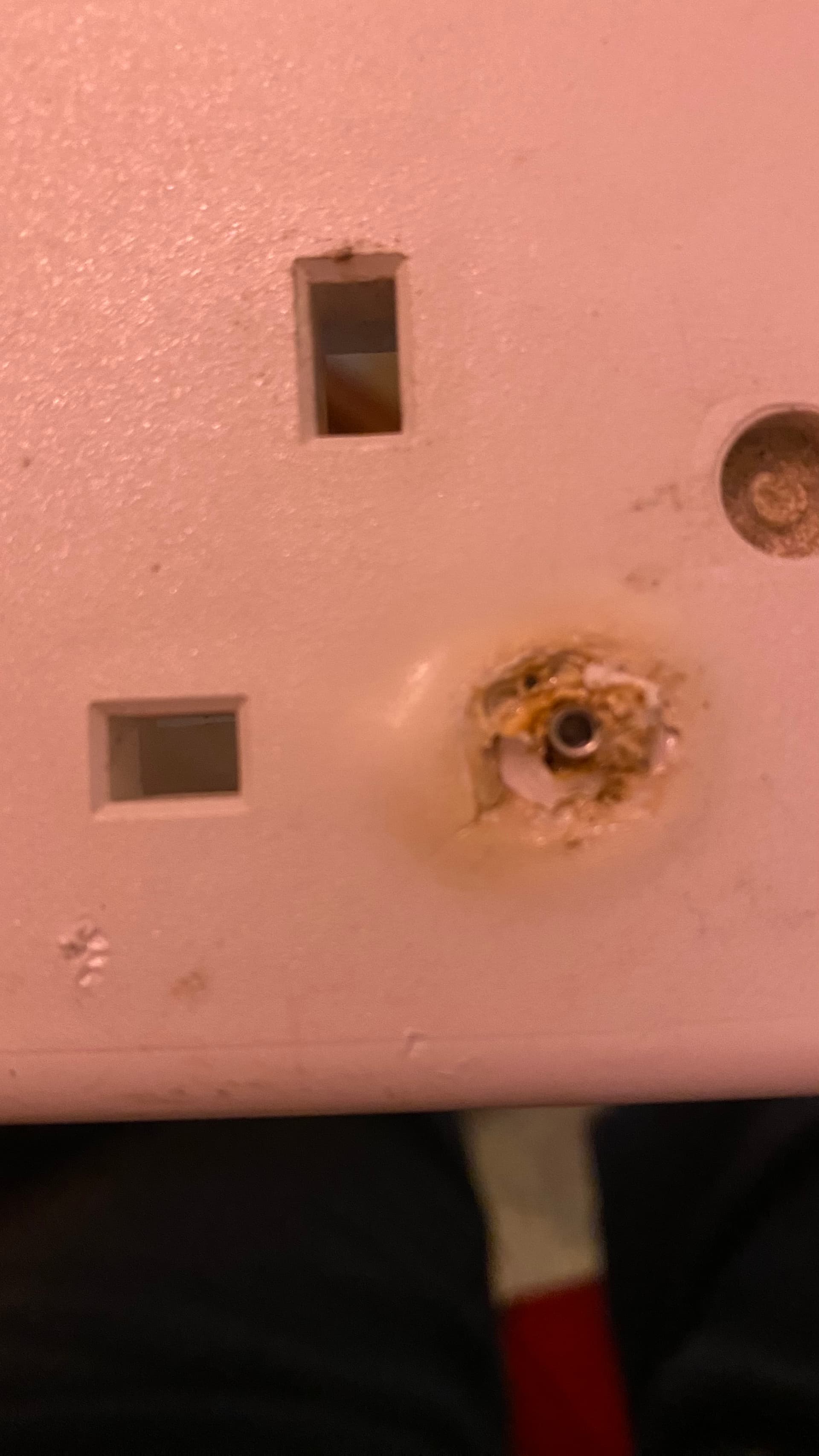

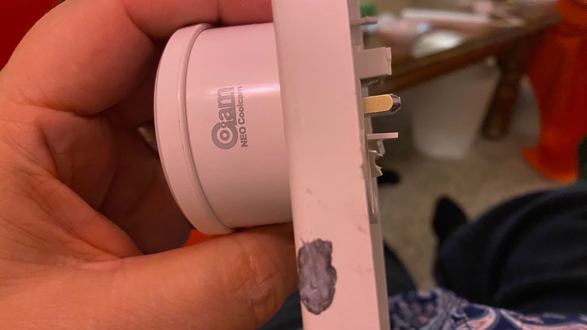

I just had a zwave Neo Coolcam where the Live Terminal that plugs into the socket melted.
Noticed the smell first, then that the washing machine had gone off mid wash.
The washing machine was pulling 2.5kW, 10A, the Coolcam melted into the wall socket!
Fortunately the Coolcam had switch off power.
The socket was fused with a 13A fuse and that did not blow.
Now moving all my Coolcams offline, maybe put them on something that draws less power, a USB charger etc.
Just be very careful using these.
That could have been much much worse.
