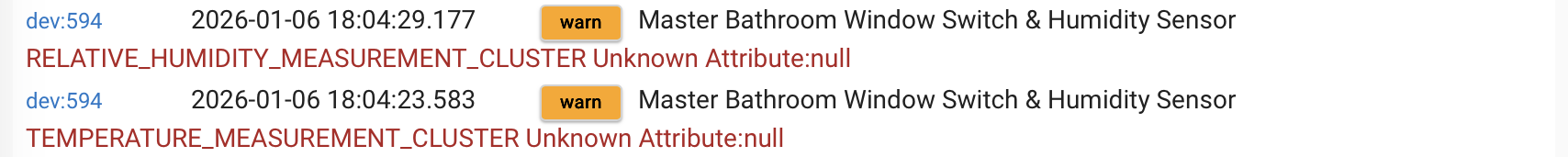

I have one that is similar, but likely different:
Has been here for a while and I have not done anything about it.
This is one i took yesterday I have a ticket open with Inoville on this no reply as of yet.
