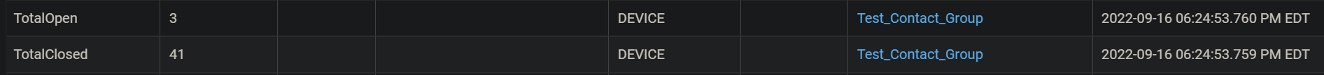

@bertabcd1234 I seem to have induced another race condition somehow.
I have the device sending debug level logs of the totalOpen and totalClosed counts and every now and then it's off.
I toggled a sensor open and get these device events:
The app (using the state variable from getCurrentCount) is correct. The driver logs are incorrect, even though they came in after the device event.

That I'm not sure about; seems the true in device.currentValue(x, true) should return the non-cached value, so my guess is again that it's not quite enough time for the event/new database value to have been fully committed.
Are these parent/child apps and drivers? If so, one solution would be to make a single authoritative source for this value, perhaps in the app (and you might want to make it either singleThreaded: true in the definition or use atomicState instead of state in case multiple instances might run at the same time, or want to). You can create a method in the app that a child device can call to retrieve this value (it cannot access state on the parent app directly). I'm not saying this is the most elegant solution--I don't know enough about your app/driver design or goals to say that. It's just a possible solution. :slight_smile:
