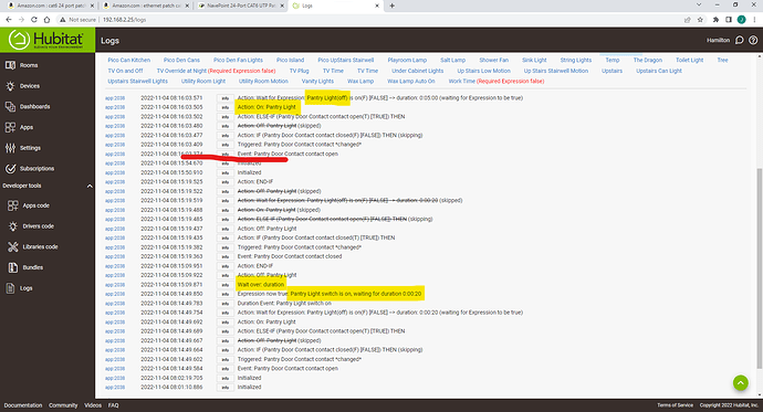

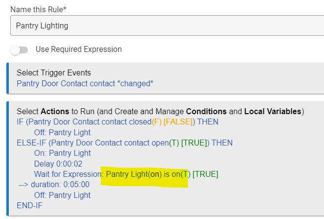

But.....Hubitat can't see that the light is on....or at least the rule can't see it. I re-did the rule this morning and put the wait for expression to 20 seconds for testing. Everything worked great. When I extended the duration to 5 minutes, it stops working again. The problem is the reporting. It turns the light on and then the rule thinks the light is off (see screenshot). When I go to the device page for the light, it shows current status: on, but the rule is showing it's off. Am I missing something simple?
The rule worked. I changed the duration, and now it doesn't. How would the duration change the current status of the light? The red line is where I changed the duration. Below worked with a 20 second wait. Above does not work. Please help!! I think I'm going crazy.
and further, I went back in right after the rule didn't work and shows it's waiting on the expression to become true, and the rule is showing that the light is on.
So rule shows it's on, device page shows it's on, log shows it's off and the wait for expression is false.
The logs in the first post do not match the rule in the second. Either way, you've likely induced a race condition that's part of your headache. Looking at the logs from the first post, the wait for expression appears to have been evaluated before the device status was updated to ON. I think I would just change that action to wait the 5 minutes and then turn off the light. The wait will be reset if the door is closed/opened and you won't have to worry about the expression being evaluated incorrectly.
Thanks for the reply!! I realized that after I posted the screen shot. You are correct. I opened the rule to add a delay thinking that it might need a few seconds to update the status. I added the delay, and then took the screenshot. The rule was the same (minus the delay). At that point, I hadn't hit "done" so it wouldn't have re-initialized yet.
Side note though, I'm assuming the race condition you mentioned is that the device status doesn't have time to update before the wait starts, so it sees it as off? I haven't heard that term, so I just wanted to make sure I understood. I've tested it with the delay inserted at one second and it seems to work now. I'm not sure why the wait duration would change that, but the delay seems to be allowing it time to realize the light is on.
