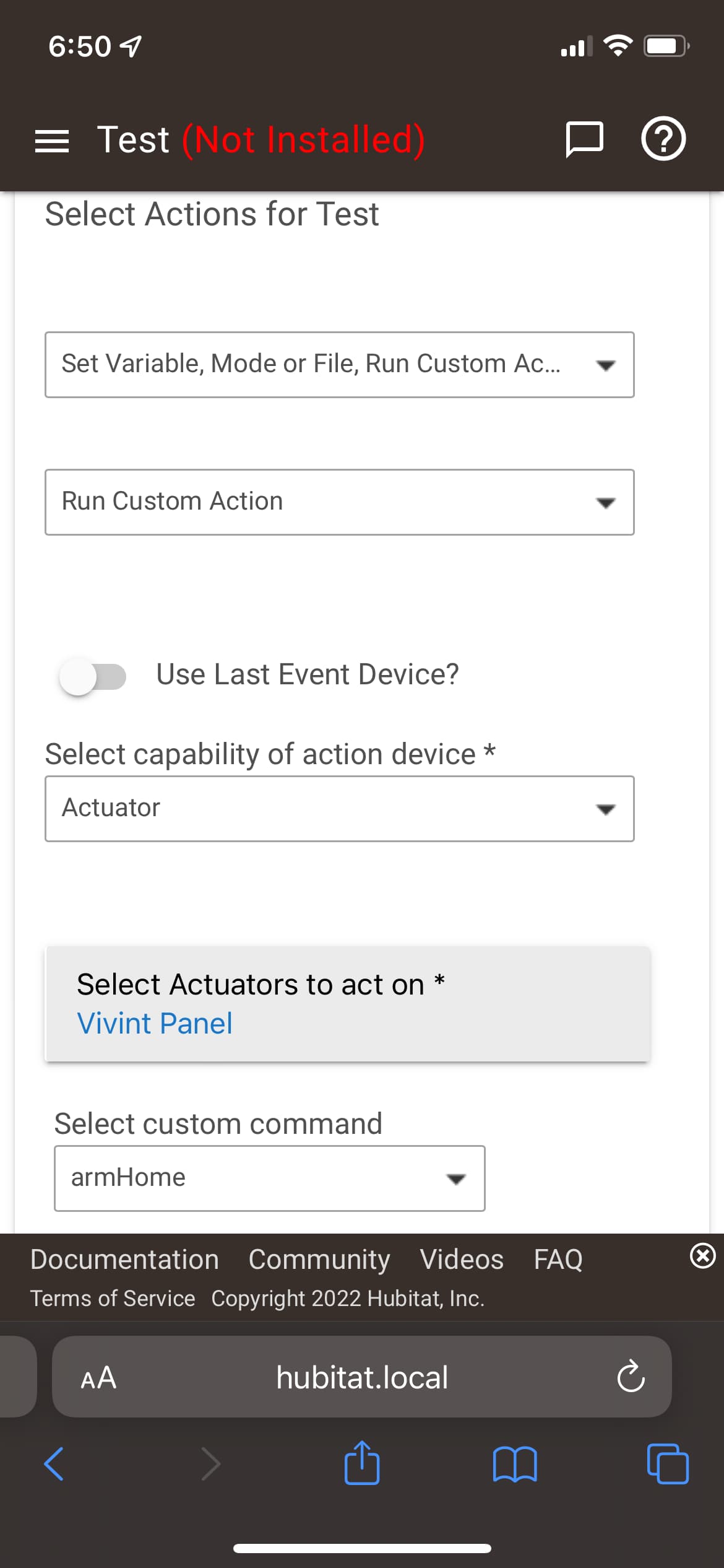

Ok, definitely a version support issue as mikee385 stated. I also found an easier way to control nodejs installations. Using fnm made the process a lot less painful. I've run into a new problem. I see the Panel as a device and can command it's status directly to Home,Away,Disarmed, but I can't seem to use Rule Machine to actuate the commands for automation purposes; I intend to use virtual switch on dashboard so I can set alarm status. No tile for Panel is included to make this happen otherwise.

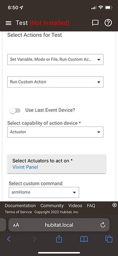

For Rule Machine, you can use ā€œRun Custom Actionā€ to set the state of the Panel:
:flushed: I had honestly forgotten that I didn’t finish those. I noticed yesterday that the thermostat wasn’t done when I was looking into the version issue, but I hadn’t noticed the garage device, so thank you for pointing that out. I’ll try to put some time into it soon. Garage device is simpler, so I’ll likely work on that one first.
Oh.. thank u thank u thank u. I did the rule change again, somehow it just didn't seem to take the first time, but now it seems to be fine. Virtual Switching w/ dashboard definitely works, though Hubitat's aesthetics leave much to be desired. Look forward to Beta testing your device changes. Vivint really has no clue what they're missing out on. U'd think that enhancing customer experience and expanding automation control would be a selling point for them, but other than their alarm systems, they've been stagnant for years.

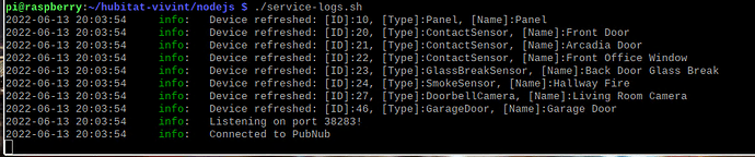

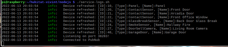

Quick update... 10.17.0 up to 16.15.0 now seems to work just fine under Ubuntu. Service setup is still an issue.
Ok, got a VM pi running properly, and it's service did start, so the versioning issue has been fixed. I did not follow-up w/ the integration app to see if it still works (wrong subnet anyway), but given that the localhost test looks the same as before, we can assume integration is fine. Still stuck on the Ubuntu service install option.

I'd be fine with upgrading, if that were an actual option. Raspberry Pi refuses to upgrade to anything newer than 10.24.0 I've tried snap, nvm, fnm, and the end result is it thinks node doesn't exist, even though I can see the file. Ubuntu..., doesn't have this problem. The only thing stopping me from using Ubuntu instead is the lack of instruction on how to setup the service part.
Ok, found a solution to the node won't update past 10.24.0 issue. fnm, n, nvm, apt, and using nodesource bin distribution will not upgrade node for reasons related to how rasp is maintained. Using snap was the only way I found to bypass this issue, because it installs it's own separate version of node. The catch u can only go up to version 15.x in the normal channel, which is fine for what is needed. After that, the only issue is to make sure to change the path for npm from /bin/... to /snap/... in the hubitat-vivint.service file before installing it, or systemctl will error.

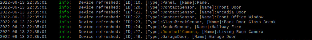

As an aside, cause I'm more focused on the Garage and Thermostat devices, I've noticed that node is identifying regular cameras as doorbell cameras. I'm not making much of this since mine is currently offline, but I'm sure it's likely to affecting others.
Can you send me a PM with the contents of:
http://[ip address of your raspberrypi]:38283/snapshot
I’m not sure if there’s anything private in there, so a PM is probably safer in this case.
That’ll help me configure the cameras better. I only have the doorbell camera, and I was speculating when I configured it separately from the normally camera.
