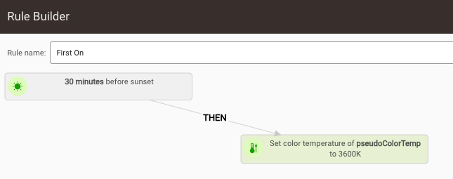

Nope, you've missed nothing
I'd say you're interpreting it differently from me, though.
I interpret that Rule to read: IF it's 30 min before sunset, do turn on a bulb at 3600k
To me, the IF is implied by the first condition.
