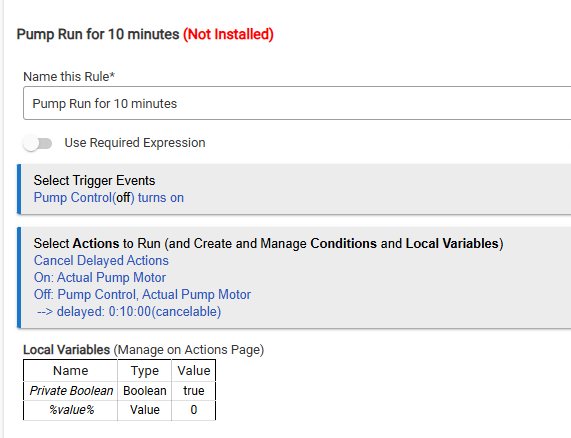

then create a rule something like this.

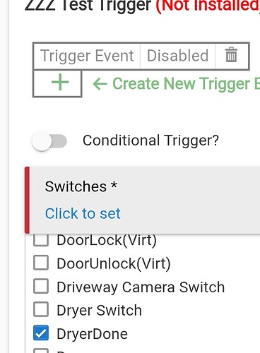

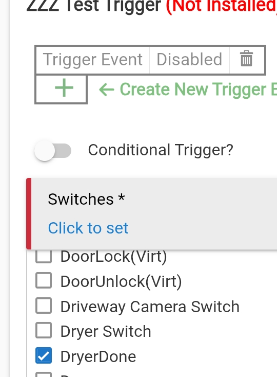

There is no category for "virtual" devices in rule machine that separates them from physical devices. So, it will just show as a switch in the rule machine device list. You just have to remember what you called it when you created it.
I have a virtual switch that I turn off after I have taken clothes out of the dryer so I can stop the reminders. It is called "DryerDone" In the list below,some of the other switches are actual switches others are virtual. (Note: I have a Door lock/unlock one that I also created a virtual switch for as well. I added (Virt) to the name for another reason - but that is another trick you could use to separate out the virtual from the non.)

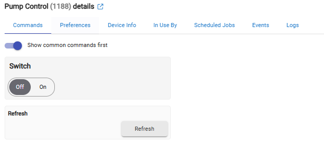

Plus I don’t see how to edit my posts. I called it “Pump” but it doesn’t show up anywhere except in devices
So I’m guessing your “Pump Control” is the virtual switcj?

“Pump control” is the virtual switch. It’s used to trigger the rule
“Pump actual” is the real Pump motor switch
I always use rule machine but I suppose you can do it in basic rules too

One more question: Where do I find Cancel Delayed Actions ?? And what does it do?

BTW, this Rule preheats my hot water to the kitchen sink or dishwasher, using a seperate circulator.

The cancel delay actions is to handle the case that the rule gets triggered again before it has completed. This can create problems due to delays within delays.
So the cancel delays kills the last delay that is timing out and the new action starts another 10 minutes cycle. So the rule will run the pump for 10 minutes AFTER the LAST trigger.
