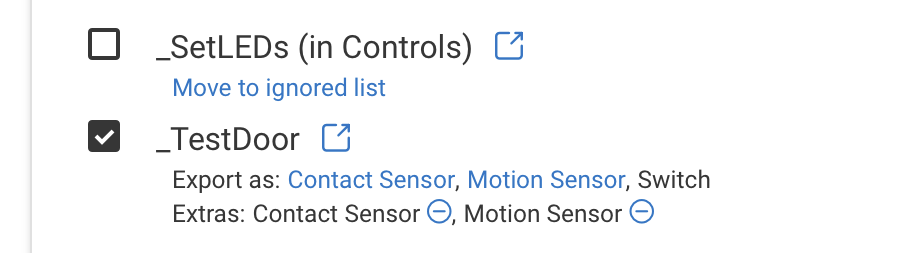

You are talking about “HomeKit Bridge’, right.
You should see then in Switchrs section like these two virtual switches :
If the checkbox is checked it should appear “somewhere” in HomeKit.
You change its room in HK to get it where you want it.
