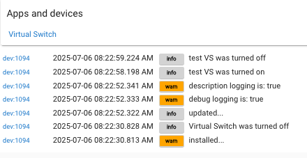

Like @bobbles, I followed your steps and got a working result:

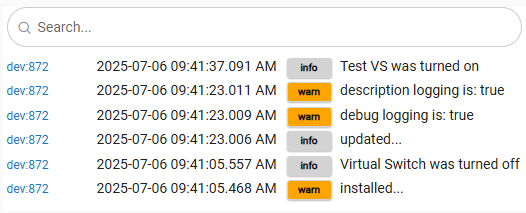

Tried the "Rebuild Database" / Reboot, and did it again with the same result:

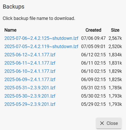

This may be unrelated, but it seems that the automatic backup stopped working a few weeks ago as well.
Additionally, if I try to create a backup now, it creates an HTML file containing "backup file not found".
Thoughts?
In order to fix the backup problem, I followed instructions posted in the community to reboot, and immediately restore the backup created during the reboot. After doing so, it has fixed my issue with the "Auto Off" not working. The cloud backup is still failing, but I'll tackle that next.
