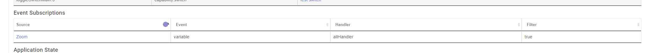

Here it is.
Hi @bravenel, any updates on this?
Hi, yes. I just tracked down the bug. Fix will be in next release. Sorry it took so long.
No problem - thanks for the fix!
