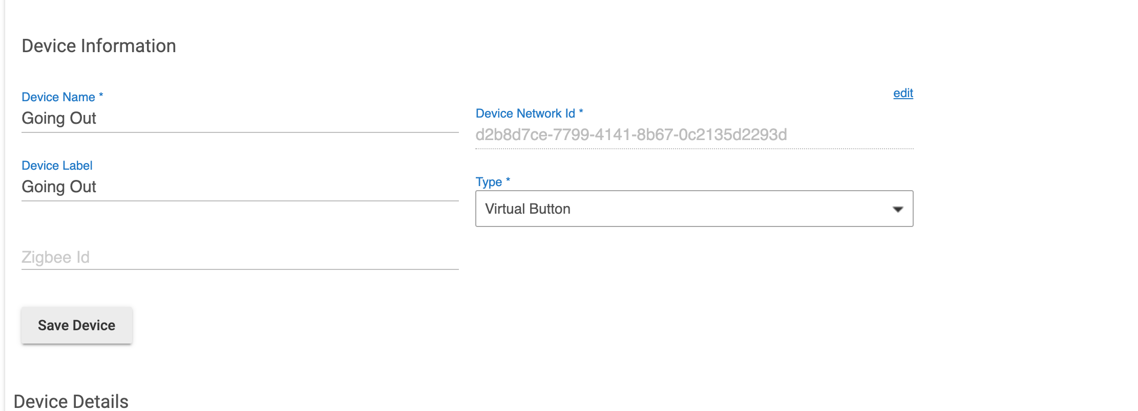

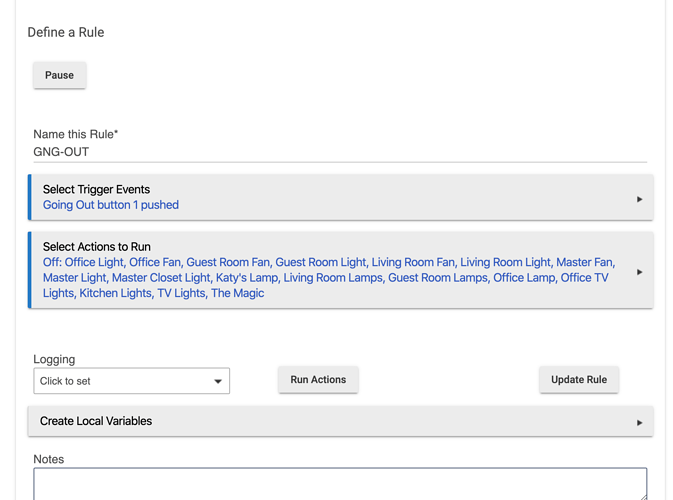

I thought I had this one figured out last night, but it didn't work. I created a virtual button called "Going Out" then setup a rule so when it is pushed, it will turn off different switches and lights around the house. When I push the button on my dashboard, I get nothing. Can anyone give me some insight as to what I did wrong in the setup?

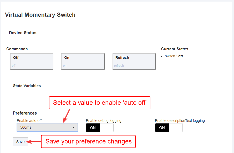

Hey @TheTrailGeek - you might consider using a Virtual Switch with the Auto Off feature enabled.
Since the Button related capabilities don't inherently expose the internal commands for push(), release(), hold(), doubleTap(), we don't expose them on SharpTools dashboards. The Virtual Button driver is a bit unique in that it exposes custom commands that are not part of the documented Button related capabilities.
@josh Thank you that worked!

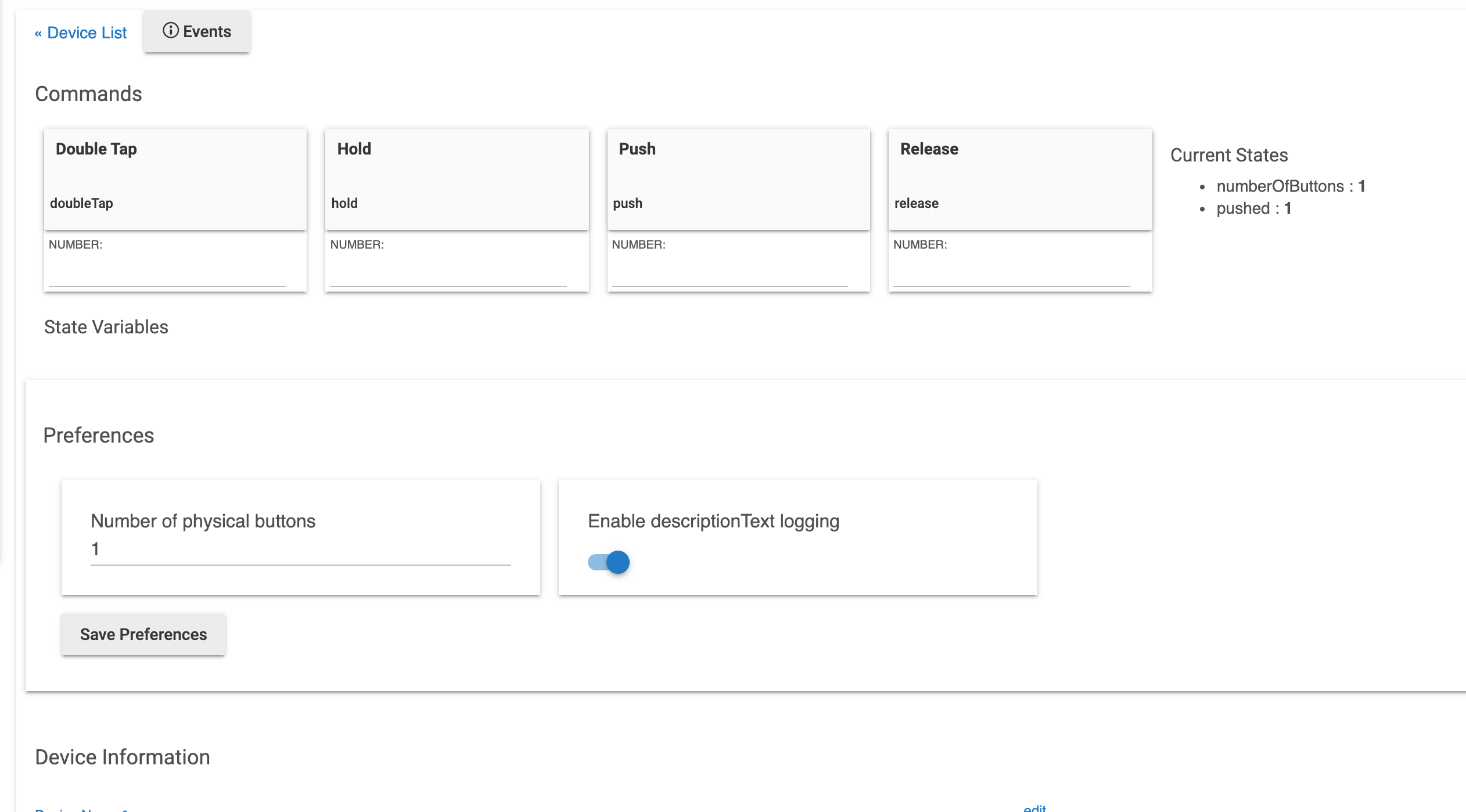

I just tried this with a Virtual Button device, and the dashboard tile registers "test button button 1 was pushed" in the Log.
In the device itself, make sure "Number of physical buttons" is set to "1"; on the Dashboard, do "Edit Tile" and make sure that "Button Number" is set to "1" as well.
