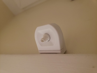

In addition to what Sebastien said, you can make a beam sensor by shielding part of a motion sensor. The beam could be somewhere that it only gets tripped when you are in the dining table area. I use this with a stairwell so I don't detect motion in the adjacent hallway.
There are a few ways to do this beam sensor conversion, some use selective application of white tape, others glue an extender ring on the sensor.
Definately would go with a motion sensor over vibration sensor. I use one under my bead pointed towards the door with a cheap led strip connected to a plug. It captures a person getting out on either side or coming back in the room. Like mentioned above you can tunnel vision them easily if it warrants it.
