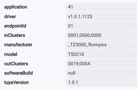

Will add some better diagnostic - whether the device is online and whether the sensitivity settings are really accepted and confirmed. Maybe the device must be configured again at the time of re-joining the Zigbee network when the batteries are re-inserted.

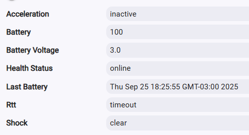

One of the addition in the latest version is that the sensitivity parameter, as returned from the device is shown in the Current States :
This is the actual sensitivity value, as returned by the device itself.
Let me know if your sensors are returning back the configured sensitivity or not.
