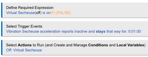

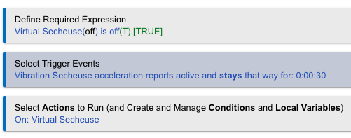

I use RM for just that purpose. I chose to implement two rules, but you could do it in one if you wanted to:
  • One rule triggers on vibration active and stays for 30 seconds (the "stays" is there to avoid false positives, like dropping an object on the dryer). The action simply turns on a virtual switch representing the state of the dryer running. The rule has a required expression on the virtual switch being off to avoid re-triggering.
  • One rule triggers on vibration inactive and stays for 1 minute. I determined with this sensor that if it remains inactive for a full minute then it's very unlikely the dryer is still running. The action is to turn off the virtual switch. There is also a required expression on the virtual switch being on.

Rule 1:
Rule 2:
You can add more actions to either rule, or you can trigger other rules (or notifiers, etc) using the virtual device on/off transitions.
