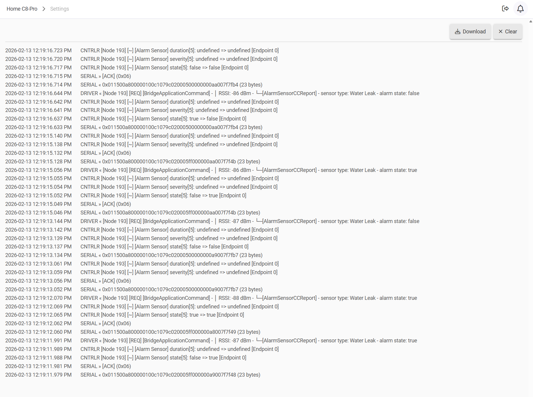

Below is the zwave log, as the device log shows nothing. and from what I can see it does see wet/dry in the zwave log, but never works on the drivers, so something in the drivers needs to be updated maybe to work with the JS Library.
2026-02-13 11:59:13.243 AMDRIVER « [Node 191] [REQ] [BridgeApplicationCommand] - │ RSSI: -77 dBm - └─[AlarmSensorCCReport] - sensor type: Water Leak - alarm state: false
2026-02-13 11:59:13.241 AMCNTRLR [Node 191] [~] [Alarm Sensor] duration[5]: undefined => undefined [Endpoint 0]
2026-02-13 11:59:13.239 AMCNTRLR [Node 191] [~] [Alarm Sensor] severity[5]: undefined => undefined [Endpoint 0]
2026-02-13 11:59:13.236 AMSERIAL » [ACK] (0x06)
2026-02-13 11:59:13.232 AMSERIAL « 0x011500a800000100bf079c02000500000000b3007f7fd3 (23 bytes)
2026-02-13 11:59:13.162 AMCNTRLR [Node 191] [~] [Alarm Sensor] duration[5]: undefined => undefined [Endpoint 0]
2026-02-13 11:59:13.161 AMCNTRLR [Node 191] [~] [Alarm Sensor] severity[5]: undefined => undefined [Endpoint 0]
2026-02-13 11:59:13.158 AMCNTRLR [Node 191] [~] [Alarm Sensor] state[5]: true => false [Endpoint 0]
2026-02-13 11:59:13.156 AMSERIAL » [ACK] (0x06)
2026-02-13 11:59:13.152 AMSERIAL « 0x011500a800000100bf079c02000500000000b3007f7fd3 (23 bytes)
2026-02-13 11:59:10.312 AMDRIVER « [Node 191] [REQ] [BridgeApplicationCommand] - │ RSSI: -77 dBm - └─[AlarmSensorCCReport] - sensor type: Water Leak - alarm state: true
2026-02-13 11:59:10.310 AMCNTRLR [Node 191] [~] [Alarm Sensor] severity[5]: undefined => undefined [Endpoint 0]
2026-02-13 11:59:10.305 AMCNTRLR [Node 191] [~] [Alarm Sensor] state[5]: true => true [Endpoint 0]
2026-02-13 11:59:10.303 AMSERIAL » [ACK] (0x06)
2026-02-13 11:59:10.298 AMSERIAL « 0x011500a800000100bf079c020005ff000000b3007f7f2c (23 bytes)
2026-02-13 11:59:10.229 AMCNTRLR [Node 191] [~] [Alarm Sensor] state[5]: false => true [Endpoint 0]
2026-02-13 11:59:10.223 AMSERIAL » [ACK] (0x06)

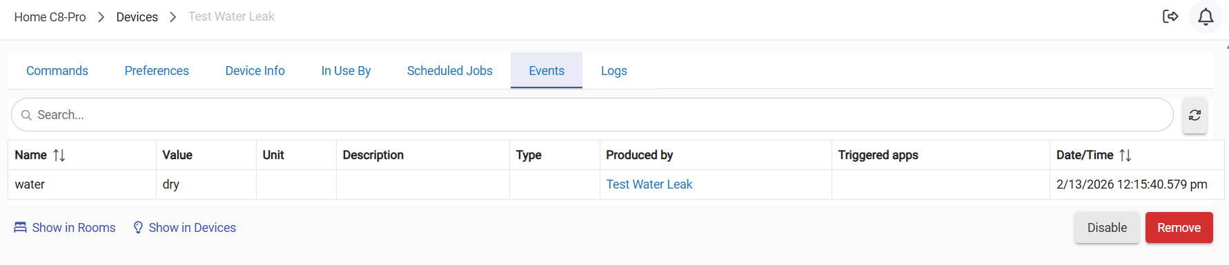

Correct!. I did just remove the device and re added it and this is what it shows (Pre testing the wet)
dev:20122026-02-13 12:15:48.529 PMwarnconfigure...
dev:20122026-02-13 12:15:40.695 PMdebugParsed '{"cc":114,"cmd":5,"ep":0,"values":[{"request":{"args":[],"command":"endpoint.invoke_cc_api","commandClass":114,"endpoint":0,"messageId":"expected210","methodName":"get","nodeId":193},"response":{"manufacturerId":96,"productId":1,"productType":11}}]}' to [[descriptionText:ST812 MSR: 0060-000B-0001, isStateChange:false]]
dev:20122026-02-13 12:15:40.692 PMdebugmsr: 0060-000B-0001
dev:20122026-02-13 12:15:40.568 PMwarnconfigure...
dev:20122026-02-13 12:15:40.494 PMinfoinstalled...
But nothing when I trigger wet, no one thing appears,
I have triggered it 4 time and noting changes:
ZWAVE log show this when I test it:
Ohhh... It's using Alarm Sensor CC..
It's an old Deprecated CC that I actually haven't seen in use before..
Going to test..

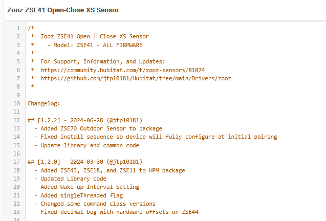

I had a similar problem with this device. I was getting strange behavior every 5-8 cycles. I switched to jtp10181 advanced driver and the problems went away. I think there is a subtle bug in the built in driver.
Its been rock solid since I moved to the newer driver.
Okay. I'll give it a try when I have a LOT of time on my hands. Maybe tomorrow. It's supposed to snow. :slight_smile:
