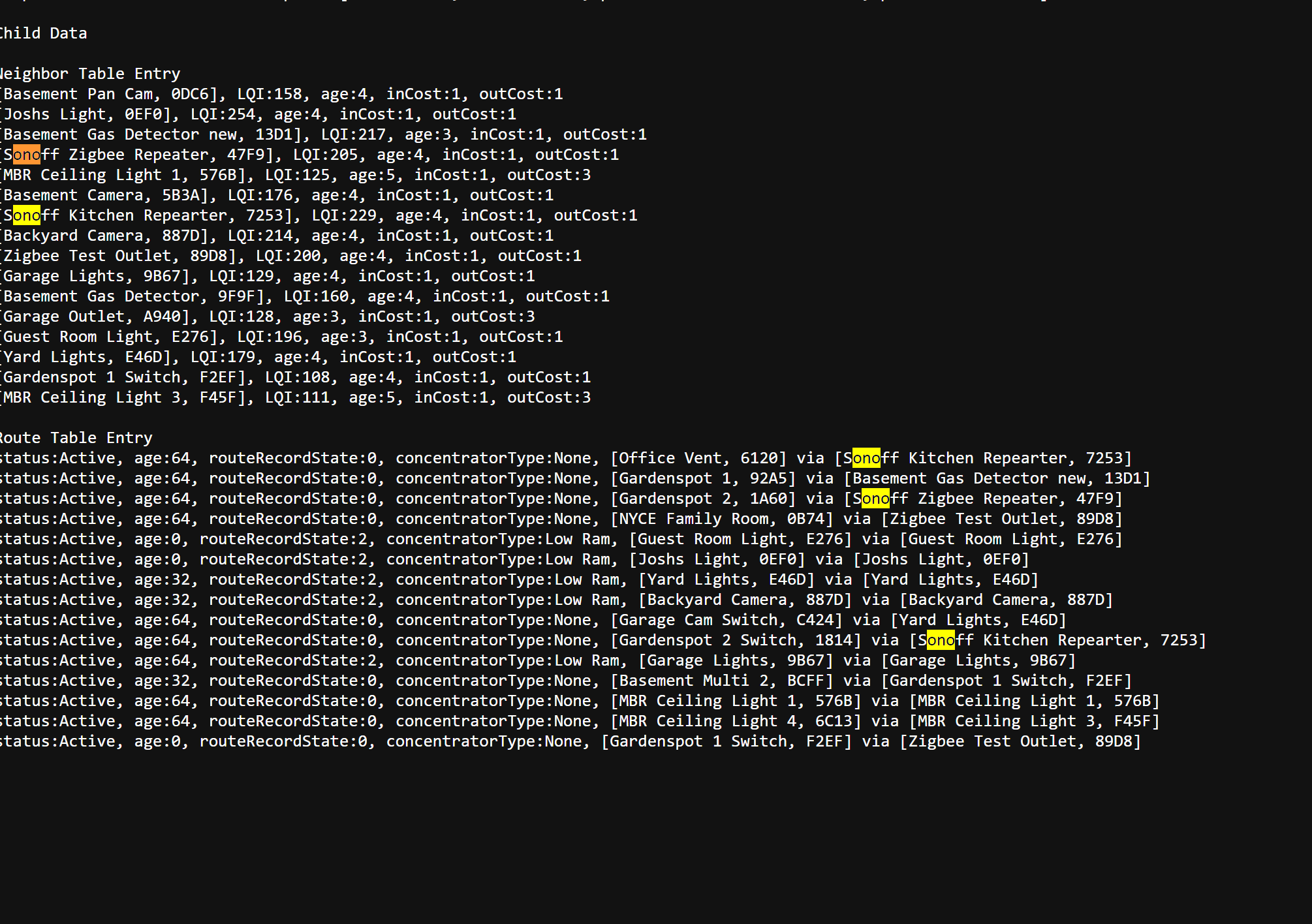

Ver .121 zigbee taking screwy routes

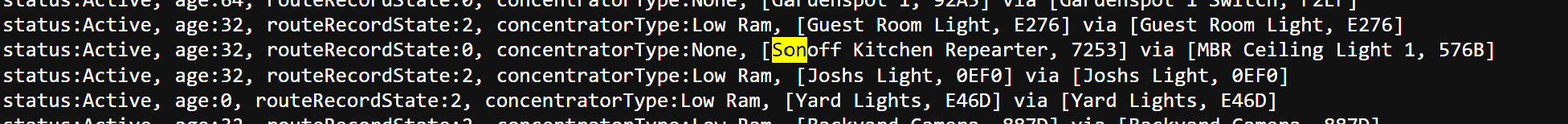

look below.. never saw this before version .121 prior my sonoff repeaters were used as repeaters.. now one is using a bulb with a low lqi and an outcost of 3 (higher than the sonoff itself which has a great lqi in the 200s and outcost of 0) as a repeater ..
This makes absolutely no sense..

zwave routes are rebuilt following a cold start. recommend shutdown hub then remove power then wait 30 secs
it did remove the screwy route... but not sure what stupid alrogithm assigned it in the first place.. is it a bug in the device or the hub....
In that example the routing did what it was supposed to do.
Outcost=0 is a special case, meaning the far end of the bidi link either never told the near end what its cost (LQI) was, or it has gone 6 age intervals without updating its status (1 age interval is 15 sec.)
LQI measures reception; it can be 'great' at the near end, and lousy at the far end. Neighbor table's LQI's are for near end (hub's) reception only. For the far end of that same link, you don't see LQI in the table, you see outCost (derived from LQI measured at the far end).
The great LQI of 7253 means the hub hears 7253 loud and clear (inCost=1). The outCost=0 means 7253 hasn't recently told the hub whether it hears the hub, at all...
So when hub wanted to talk to 7253 (which was obviously a neighbor, but at that time wasn't confirming that it was receiving) it picked another router which had advertised having a route to 7253, which evidently was 576B.
