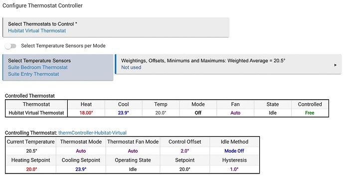

  1. Create a Hubitat Virtual Thermostat device (name it whatever you want).
  2. Install the Built-In Thermostat Controller app and specify your Hubitat Virtual Thermostat as the device to control.
  3. Select as many temperature sensors as you want to average.
  4. Press Done and it will create a device with the prefix thermController

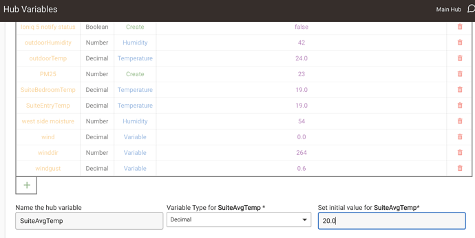

  1. Create a Hub Variable with a name of your choice and the type Decimal

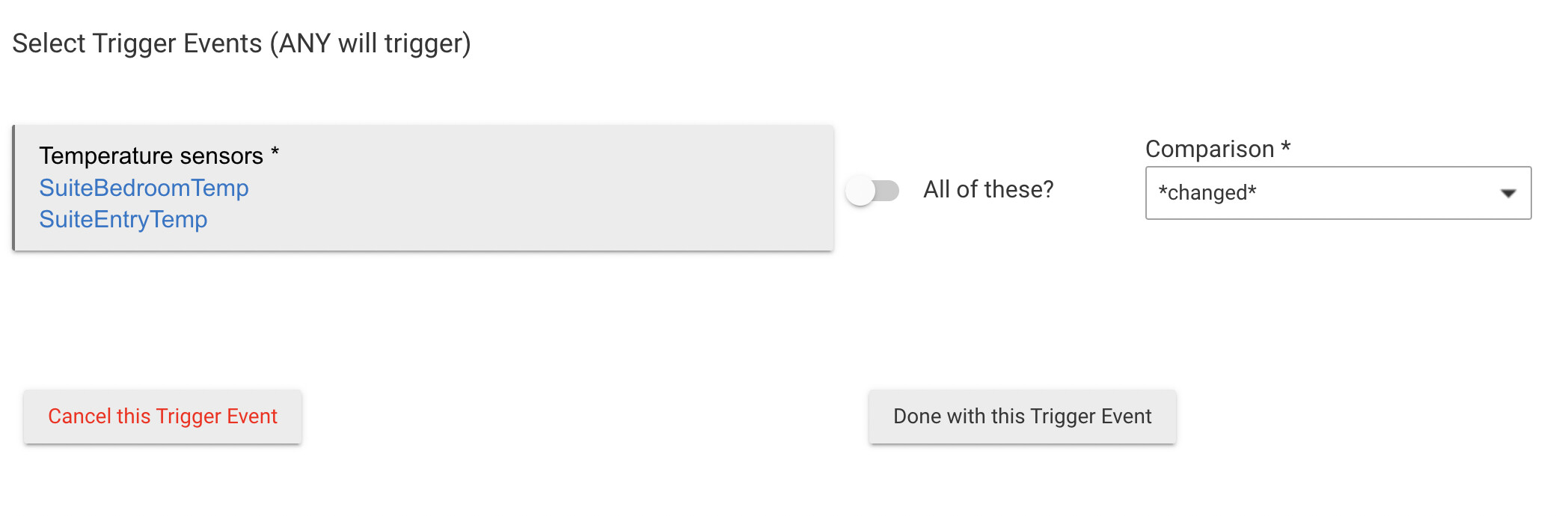

  1. Create a Rule Machine rule with some kind of trigger. I would probably use changed from any of the temperature sensors I specified in the Thermostat Controller app.

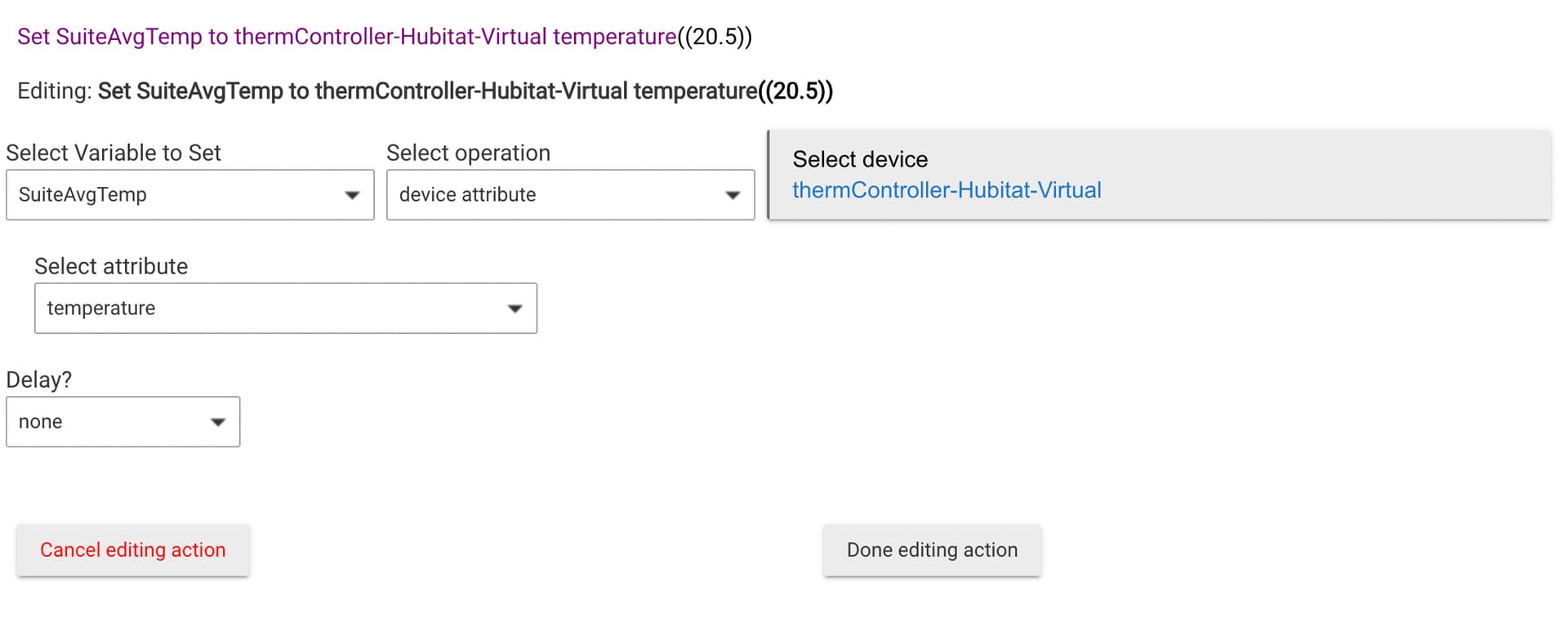

  1. Set the rule action to Set Variable and the operation device attribute
  2. Select the thermostat controller device that was created by the Thermostat Controller app.
  3. Select the attribute Temperature
You will now get an average temperature stored in the Hub Variable you created in Step 5 from all temperature sensors you selected in Step 3 and you can use that variable in Rule Machine rules, or Apps and Drivers that utilize a temperature value.
