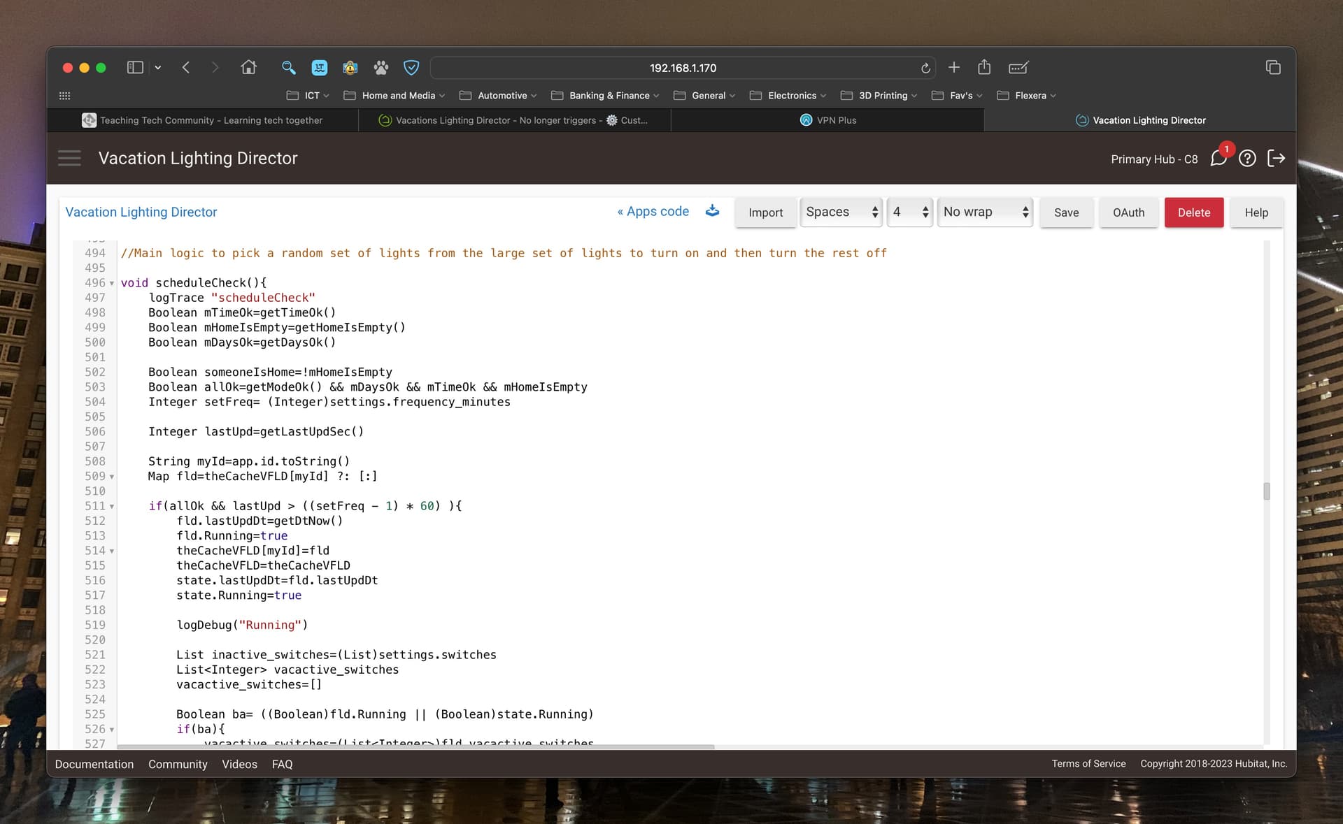

Down around line 515 try changing it so that it looks like:
private timeWindowStart(usehhmm=false) {
	def result = null
	if (startTimeType == "sunrise") {
		result = location.sunrise//.currentState("sunriseTime")?.dateValue
		if (result && startTimeOffset) {
			result = new Date(result.time + Math.round(startTimeOffset * 60000))
	else if (startTimeType == "sunset") {
		result = location.sunset//.currentState("sunsetTime")?.dateValue
I’m removing the .currentState… for sunset and sunrise

Hmmm, are you using the version on HPM?
https://raw.githubusercontent.com/lgkahn/hubitat/master/vacatlighting.groovy
Mine doesnt have anything resembling that around 515.
PS, I just noticed this version is hosted by @kahn-hubitat :man_facepalming:
I pulled the other one. Let me look at that one.
Sorry about that, I didn't check the import field, just the notes in the code. :man_facepalming:

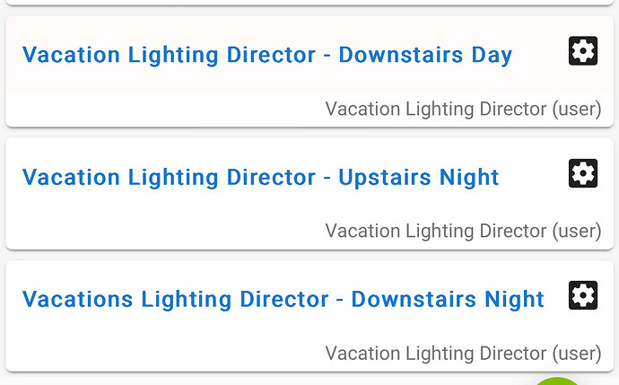

PS, I do have 3 instances of the app, installed.

Ah crap, I spoke too soon. My day automation worked, but today the night automations didn’t. The jobs are there tho.
@kahn-hubitat is there any chance that the two night apps are clashing with each other if the start time is the same?
I dont see how. Each app is totaly independent. .maybe need sime debugging to see why it is
not starting up. But if the event is there and your hub is missong events i would look elsewhere why this is occuring. If the event is still there past the time that is a hub issue as even if it fires and errors out it should disapoear.
So there are 2 possibilities
1 it fires and errors out... app issue
2. It never fires ... hub issue
Strange. I’m on a C8 (pre-matter firmware) and the schedules do appear. I’ve added a 15 minute delay to upstairs starting.
