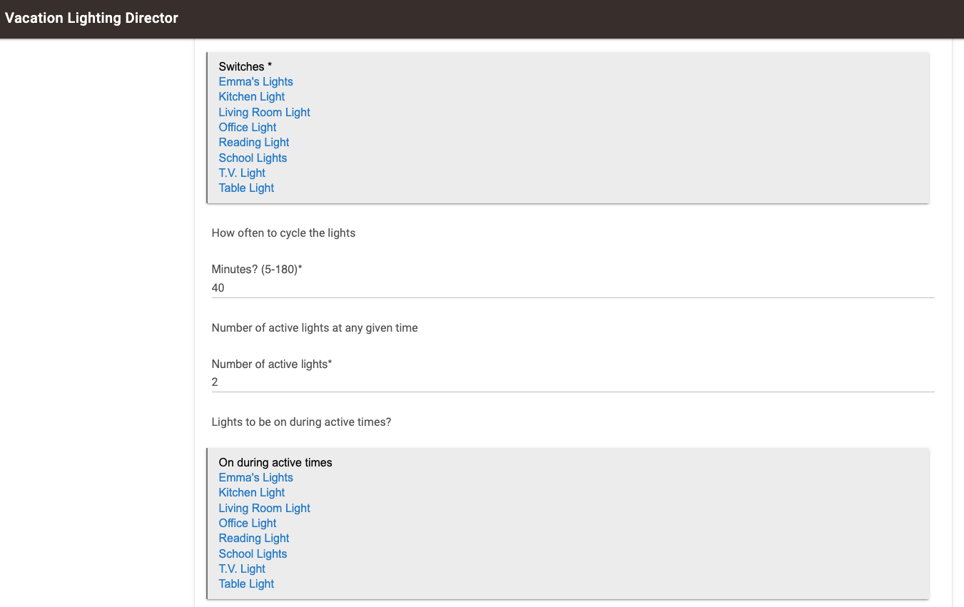

Are the "lights to be on during active times?" the light that will remain on or the lights that will cycle during vacation lighting? Can't seem to get this to work correctly.
Looking for the same answer, or some documentation on vacation light director usage.

- Switches - List of switches that will be chosen from randomly for on/off (required)
- Cycle time (mins) - time switch is left on (5- 180 minutes) if randomly selected (required)
- number of active lights - number of lights turned on for a cycle from the list of switches (required)
- lights - to be on entire active time; (optional)
- these are lights that will stay on during the active times defined by Modes, Time, presence sensors
- Examples are garage/porch lights, Holiday lights, etc.
