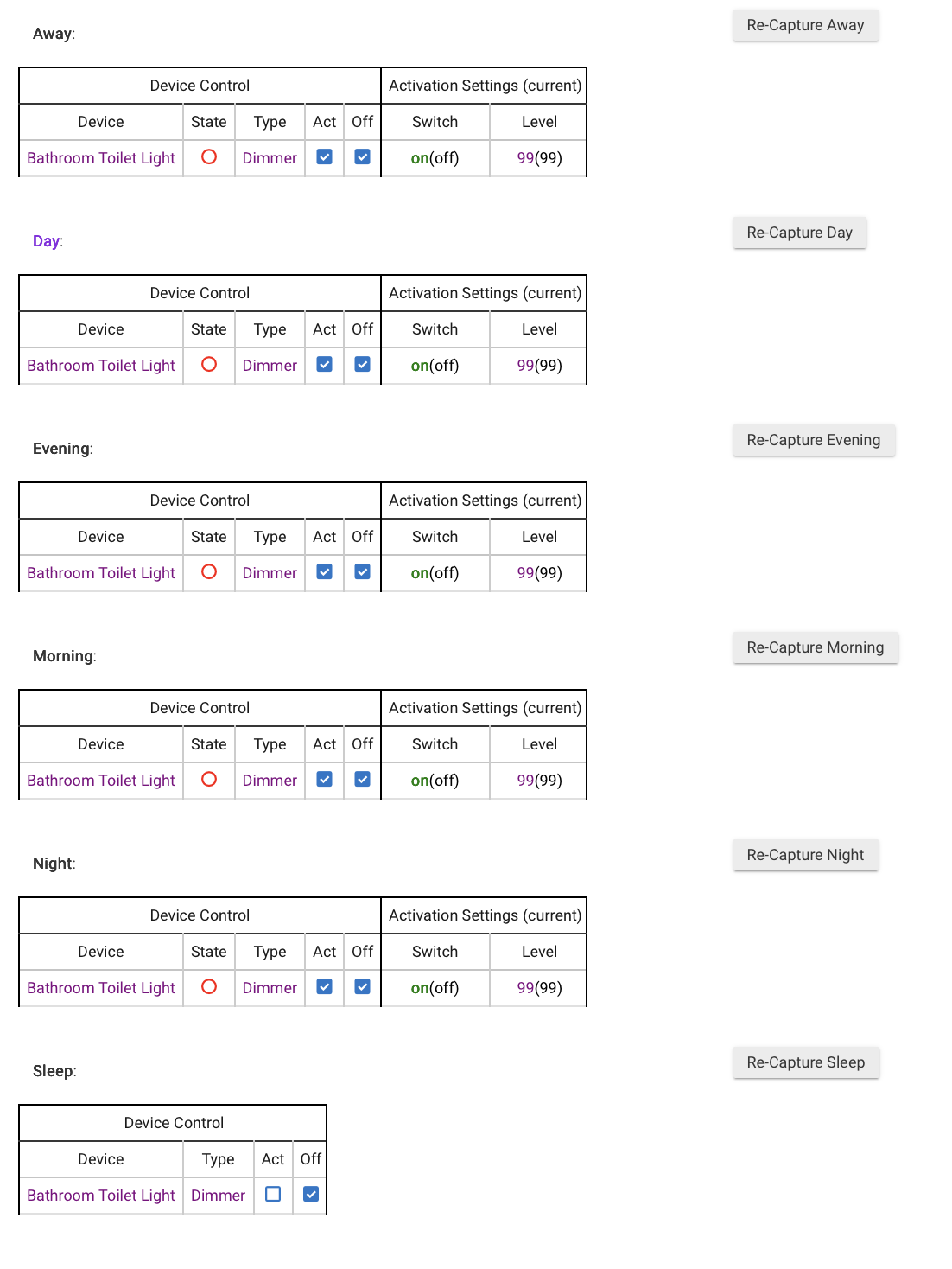

Here's a GE motion light. In manual mode, controlled by Room Lighting. Works as occupancy for most of the day, vacancy for sleep mode.
