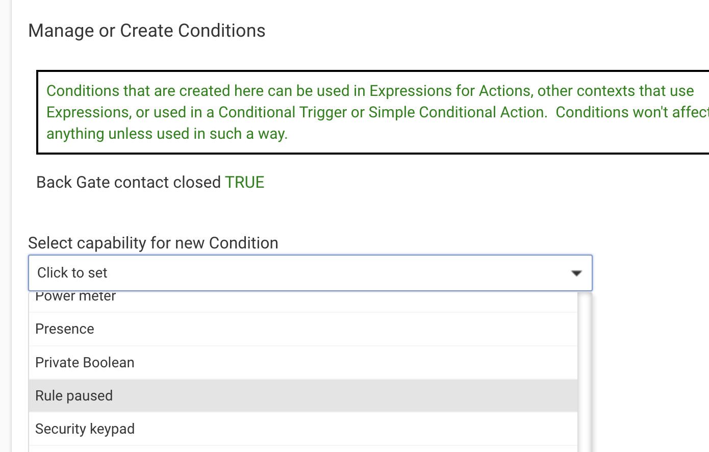

Under Manage or Create Conditions, you can select Rule Paused:
Then another pull-down shows up where you can select a rule.
