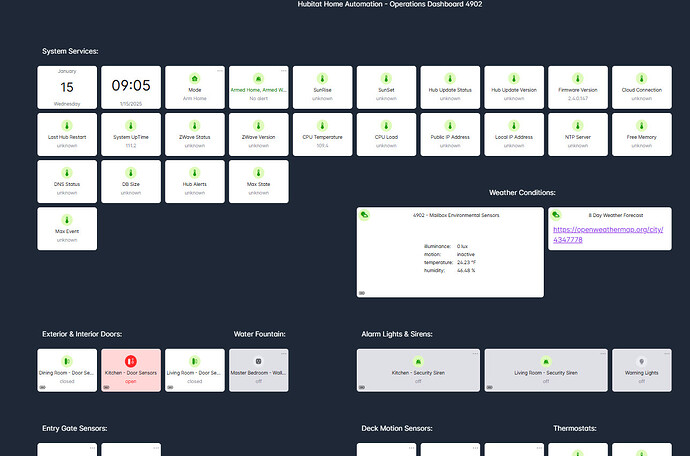

Using the hubinformation driver I setup a series of virtual drivers under the "System Services" section Easy Dashboard formatted for a windows desktop layout [shown below]. Using those exact same virtual drivers I put them in similar layout for an iPad [shown below].
Again, a BIG thank you to thebearmay :slightly_smiling_face: !!
When the drivers were added to the initial desktop layout they worked perfectly. When the same drivers were added to the iPad layout it appears only a few of the drivers are reporting data. The majority are reporting unknown. See the iPad vs. the desktop screens. I first thought that possibly enough time has not lapsed for the driver refresh times to expire, refresh, and eventually update. I do believe enough time has expired and no longer believe that to be the case.

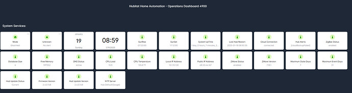

Desktop:
Dashboard
iPad:
iPad

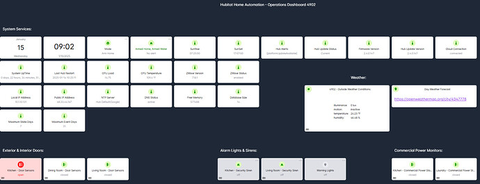

Good morning,
Looks like it is actually working as expected after all. Upon returning pleasantly found the updated dashboard below :slight_smile: !
I did leave enough time but maybe it took an extra cycle or so...not sure but working just fine after all.
