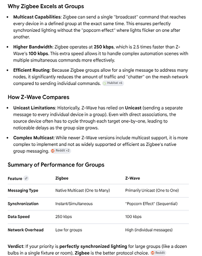

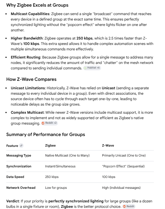

I did see Zigbee seems to have some sort of grouping scheme to enable multicasting to the group. Anybody using that and does it work well? Does it reduce Zigbee traffic?
Is Zigbee better for large groups of devices?
I have used Zigbee group messaging, which is available in both Groups and Scenes (Groups) and Room Lighting. It does reduce traffic, as it sends only a single command from the hub, not one per device. I have also suggested this to many users who have problems doing things other ways. From these experiences, I can say it tends to work better.
