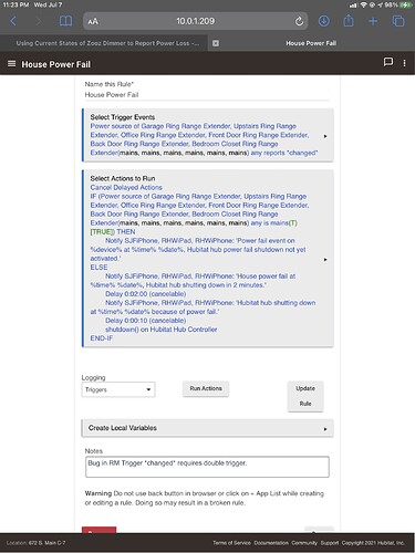

Rule is posted below.

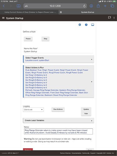

One problem, though: when you have an extended whole-house power fail, in which one rule shuts our UPS-powered hub down before the UPS fails, the Ring Extender will return to mains power before the hub boots, so that the hub misses the “return to mains” event sent to the hub by the Ring extender. So, you have to have a rule triggered on systemStart that refreshes the state of each of your Ring Extenders on each boot.

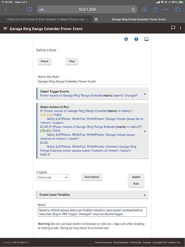

Here are the rules:

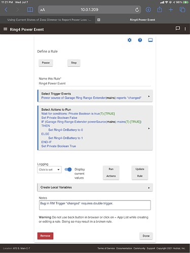

There is a similar rule like the following for each Ring Extender:
The Private Boolean enforces a critical region in case the power is flapping on and off.

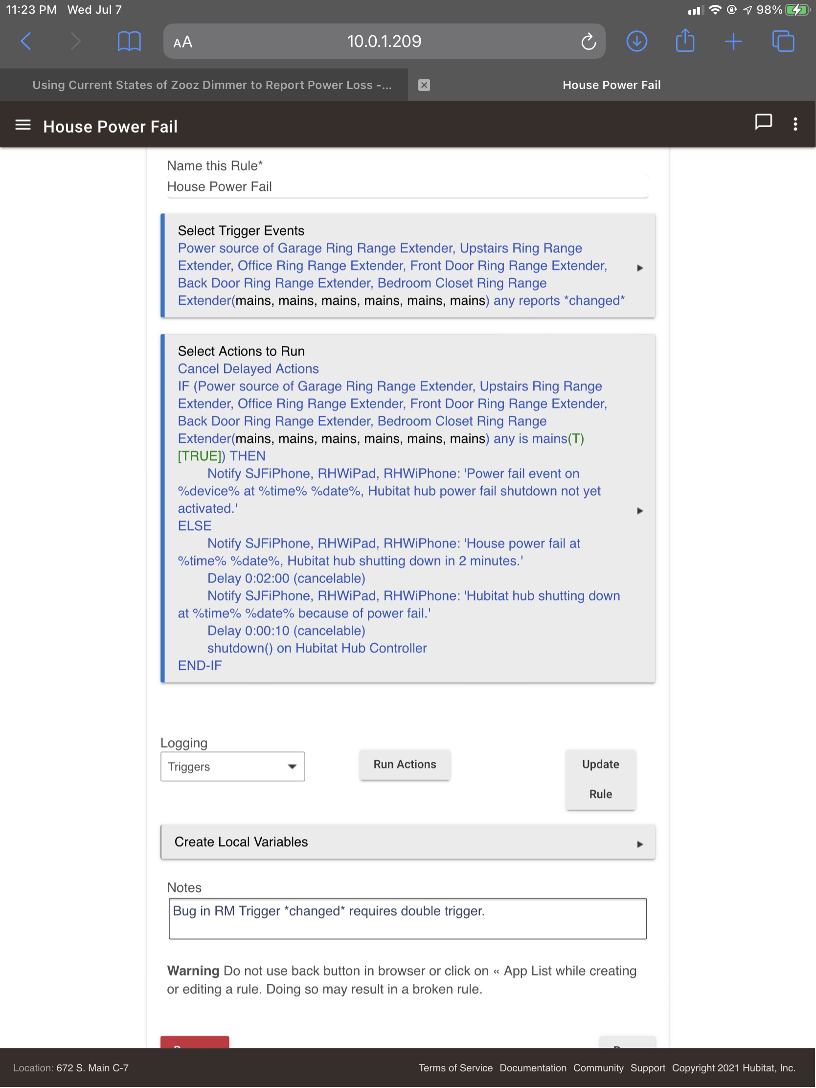

And then, the following rule shuts the hub down when all show power fail. This prevents shutdown if one breaker is tripped for some reason, or if someone knocks a Ring Extender out of the socket:
At one time I had a voting test to see if a majority of the Ring Extenders showed power fail, rather than all. The voting test simply counts, inside a critical region, the number of Ring Extenders on battery. That’s not in use right now.

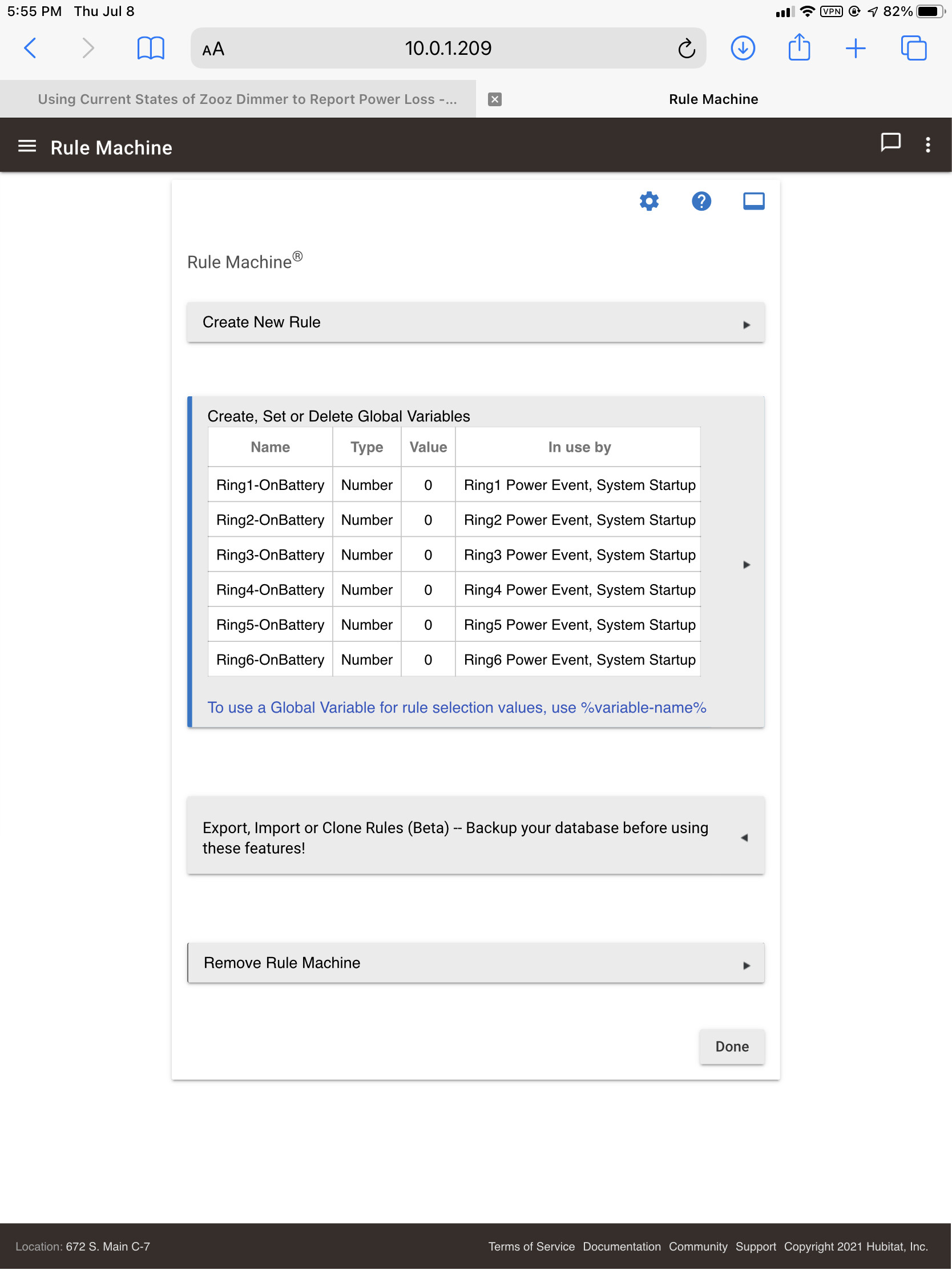

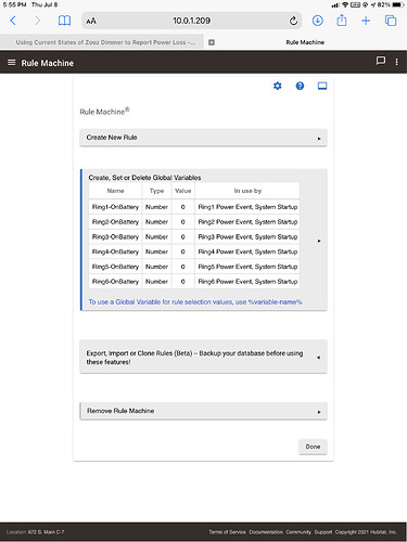

EDIT: In case it’s not clear, here are the definitions of the Global Variables that are used in the voting that replaces the first conditional in the shutdown rule. That conditional is replaced by a critical region that sums the onBattery numbers.
