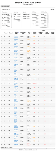

It sounds like an issue with your Zwave mesh. Either not enough devices, not enough repeating devices, or similar. Maybe post a screenshot of your Zwave Details page, and someone can spot a problem.

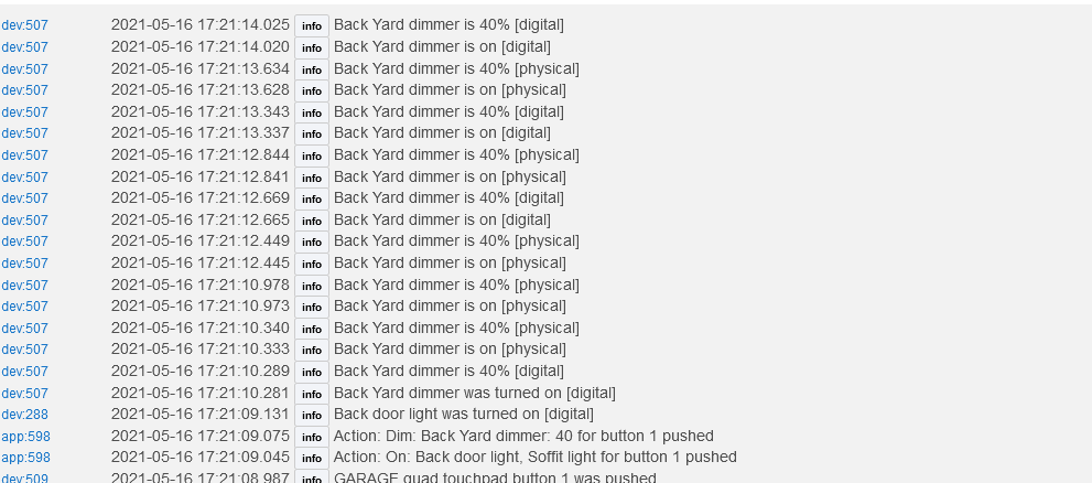

Here is the log from one button press of the Aeotech 4 button keypad with a basic rule to set the dimmer to 40% and turn on two switches:
What's up with the 9 "dimmer on" and "is 40%" though???
I have seen this several times. Is it due to the ramp rate in the dimmer or the Evalogic dimmers aren't all that good?

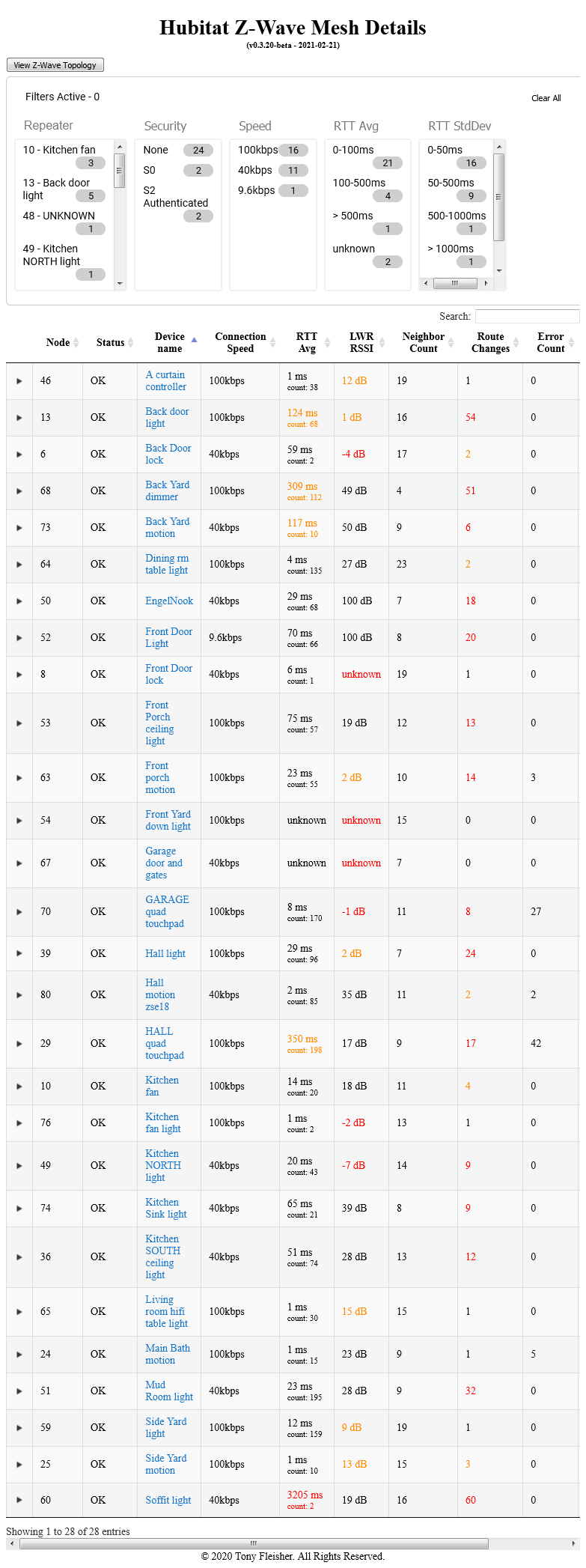

Here is a screenshot of Z-wave mesh details app:
The switches of note are 1) Back Yard dimmer <68> 2) Back door light <13> 3) Soffit light <60>
Also note that when the lights don't respond, the keypad flashes blue twice, then red.
I thought it was the keypad at first, but I used a different trigger (a contact sensor), and the lights responded the same.

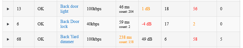

Here is a partial screen capture so you can read it.
Looks like weak mesh of some type to me. Maybe someone else has an idea, but between RSSI, RTT, and Route Changes it appears these are barely on the network. Maybe you need a good strong dedicated repeater somewhere, or simply more devices near these misbehaving devices.
