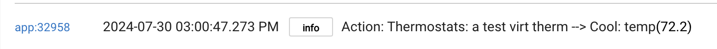

And here is the log of that action running:

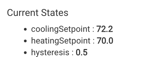

And the thermostat itself after, showing the setpoint having been set:

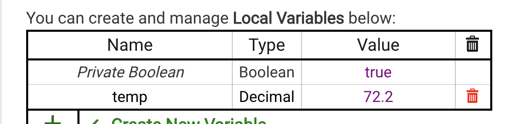

That variable is a Decimal variable:
