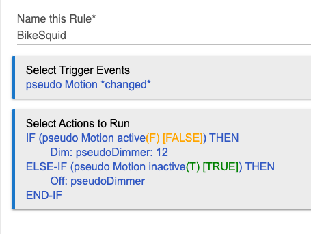

Tried to duplicate.. using only one dimming device...
Screen Shot 2021-05-24 at 9.41.43 AM

My Logs are what I'd expect.
