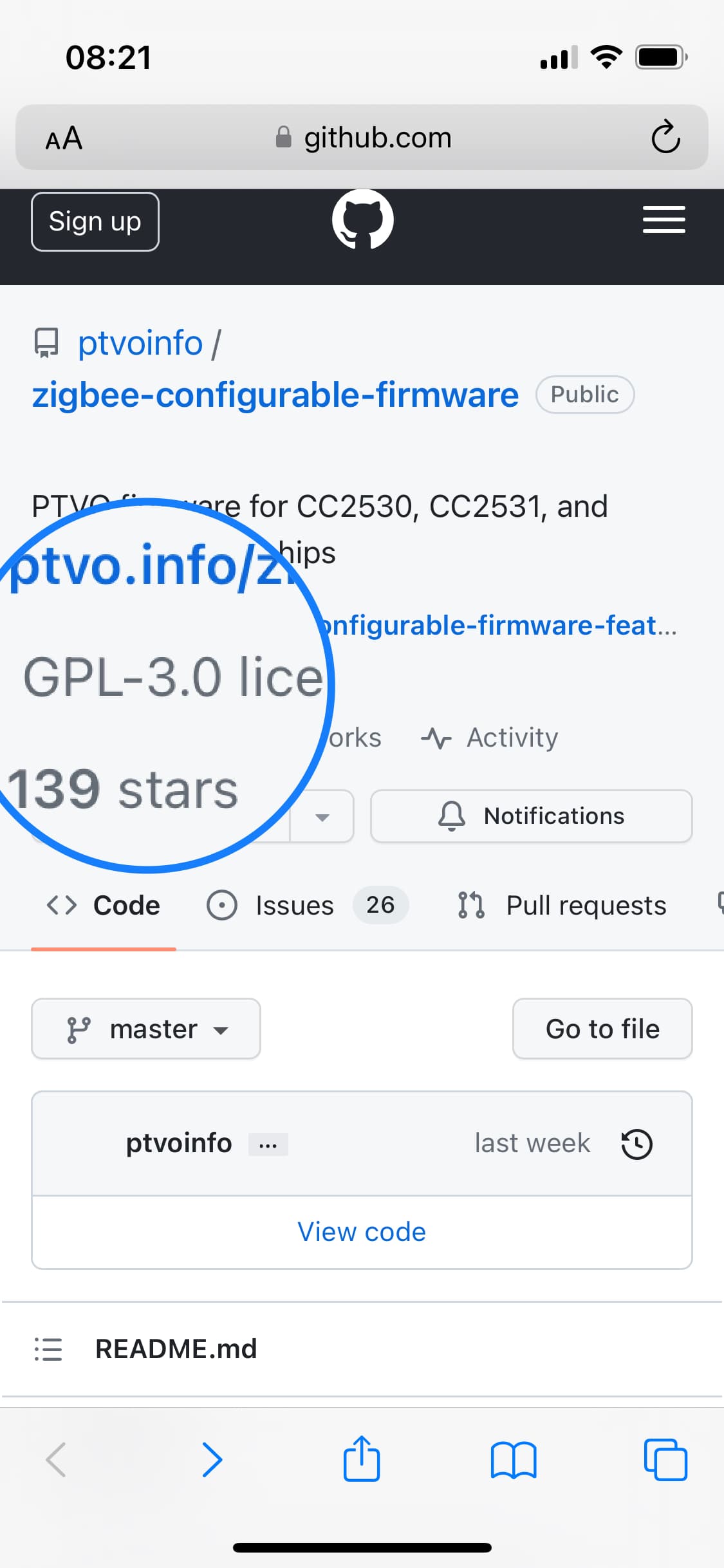

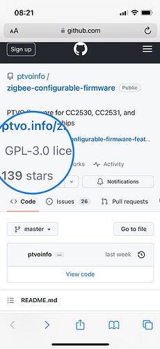

There’s some misunderstanding here that I want to correct. PTVO firmware is open source, and released under GPL v3.0.
AFAIK, not for switch devices based on the CC2652, like the one you’re interested in.
FWIW, flashing the ZBMini is very simple.

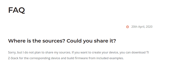

Indeed there's a misunderstanding. I'm not sure why the author labeled the repository as GPL, but there's no source code in that repository, only a *.exe for configuring the firmware images (which means us linux users might have some trouble). Any feature changes can only be done by the developer.
The developer sells a pro-version that has low power modes for battery powered zigbee devices, and has said very clearly that the source code will not be made available:
