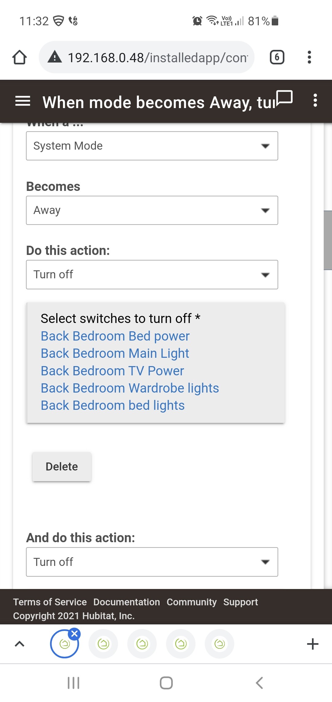

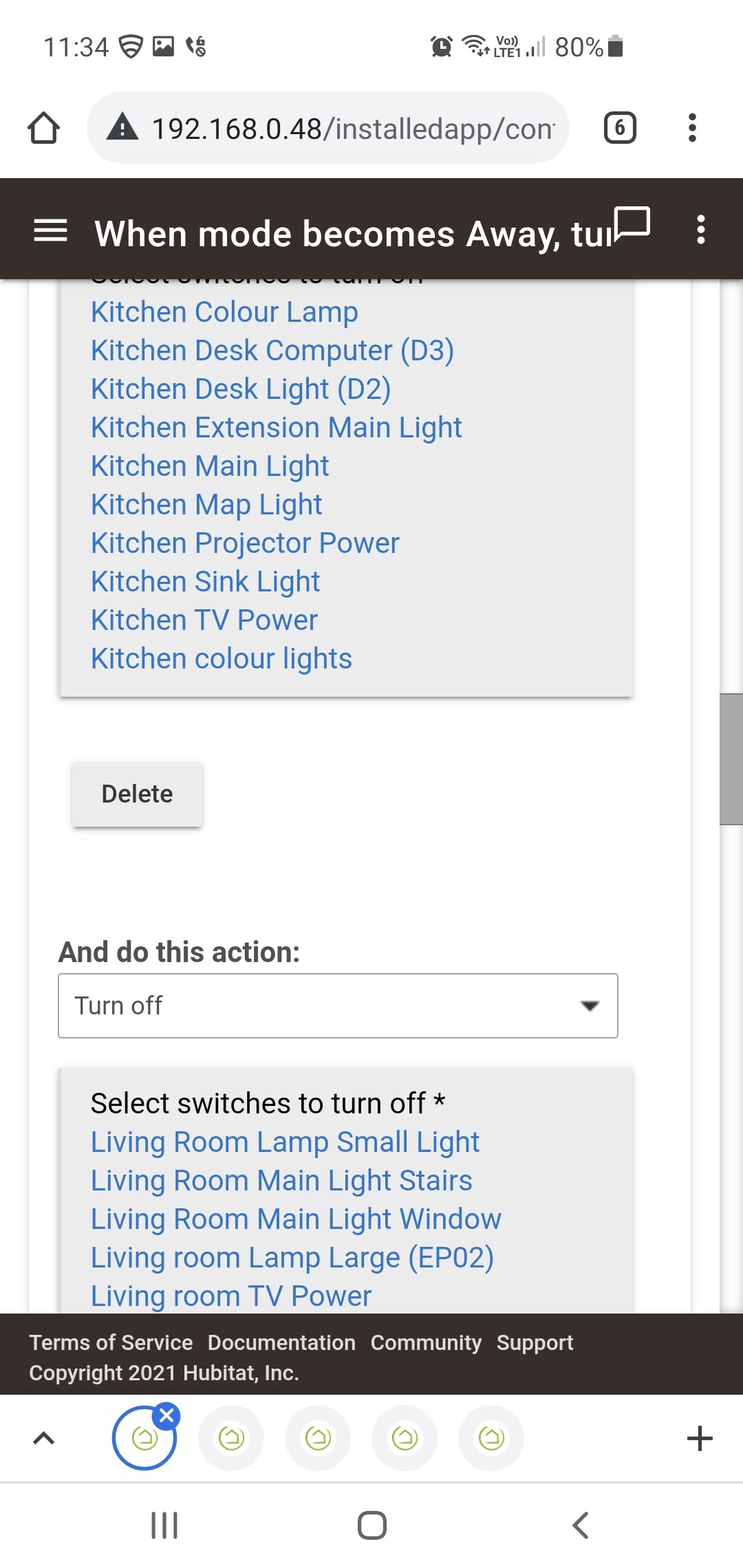

The option I chose in the end was basic rule, and group the 'offs' by room (for simplicity) so that their in smaller chunks, didn't bother with a delay and haven't had and misses since
Also advantage with BR is I can also turn stuff on in the same rule like night lights, bedside power ..
