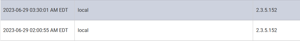

This said using the above URL produces another backup vs downloading the "latest" automated backup the hub creates during its nightly maintenance window. Example where my database cleanup is set for 2 AM and NodeRed downloads the backup at 3:30:
@gopher.ny is there a URL to download the latest maint/database cleanup backup instead of creating a new one? Would downloading this backup help with the memory situation that folks have been posting here on the Community?

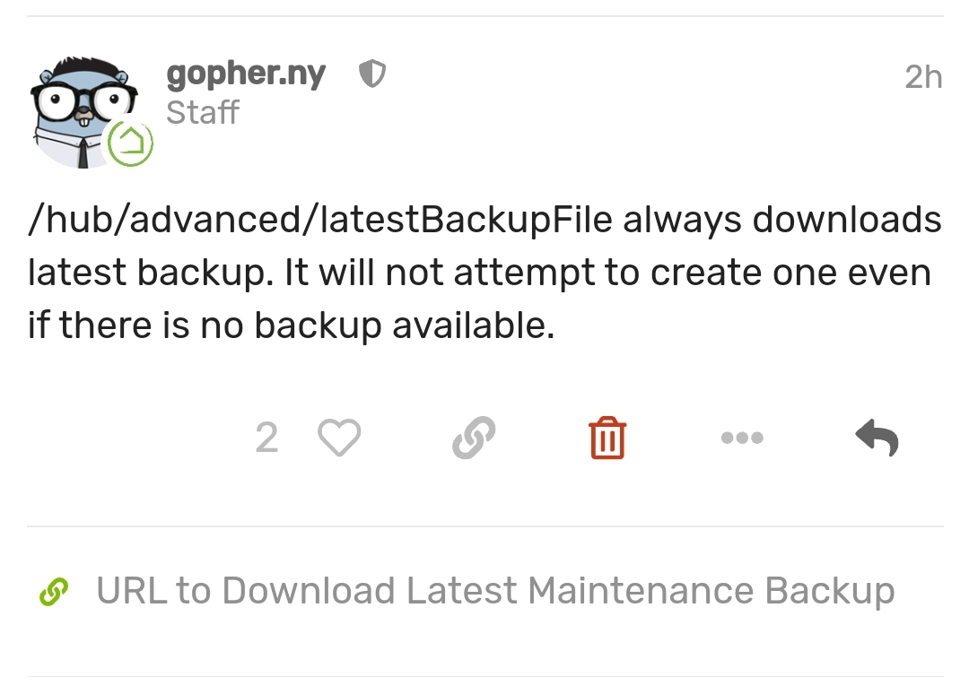

Just following up to close the loop on this thread. @gopher.ny has added an API to download the latest backup available that will not generate a new one:
HUB-IP-ADDRESS/hub/advanced/latestBackupFile
@bobbyD feel free to close out this thread.
The link you shared is not available to non-beta users, so I replaced it with a screenshot.
