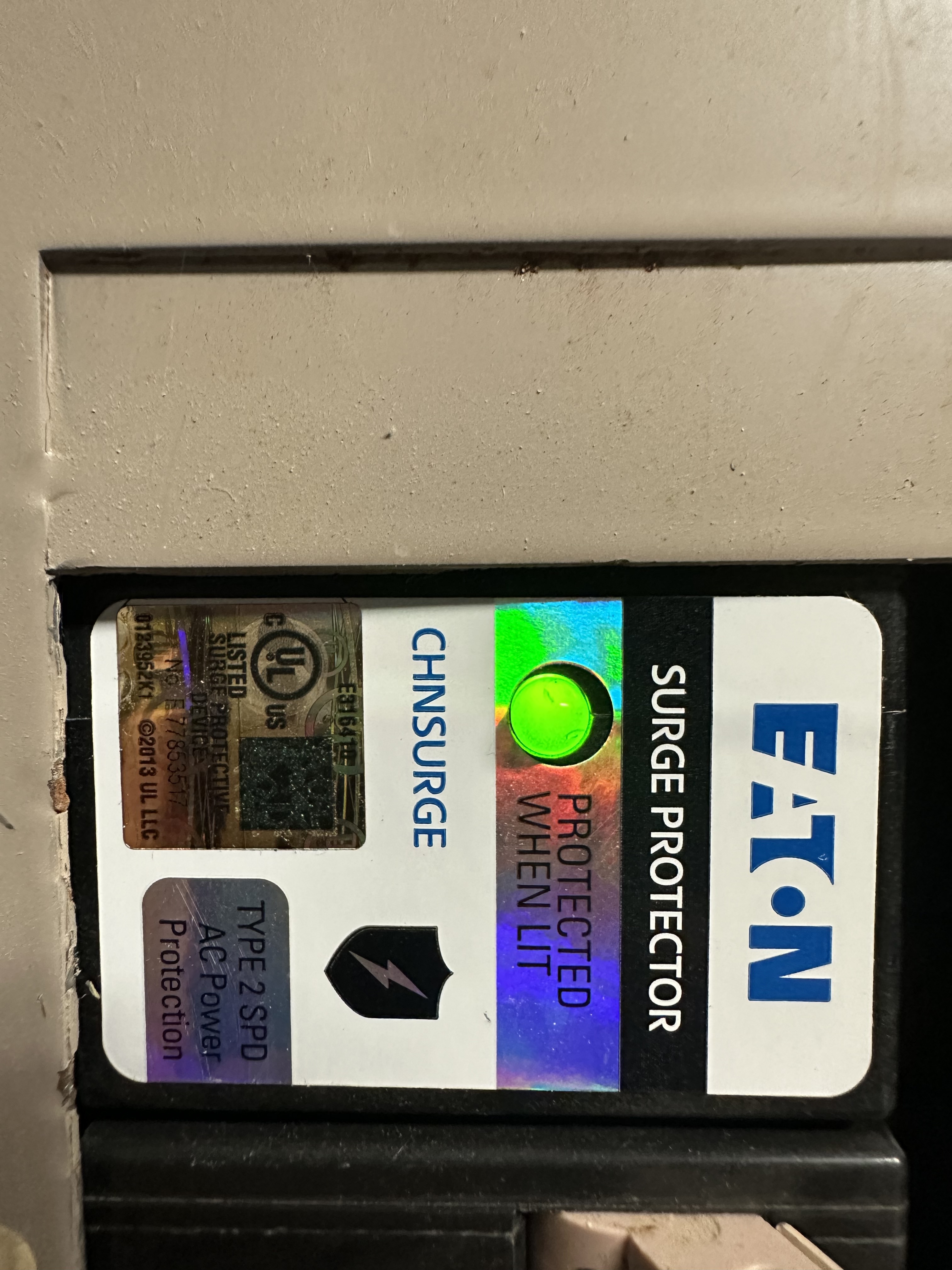

We do have a whole home surge protector. This is what we have. Not sure if it’s any good or not. Also, does that actually protect your whole home from an actual EMP attack?! Or is that just the name? Haha

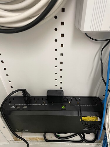

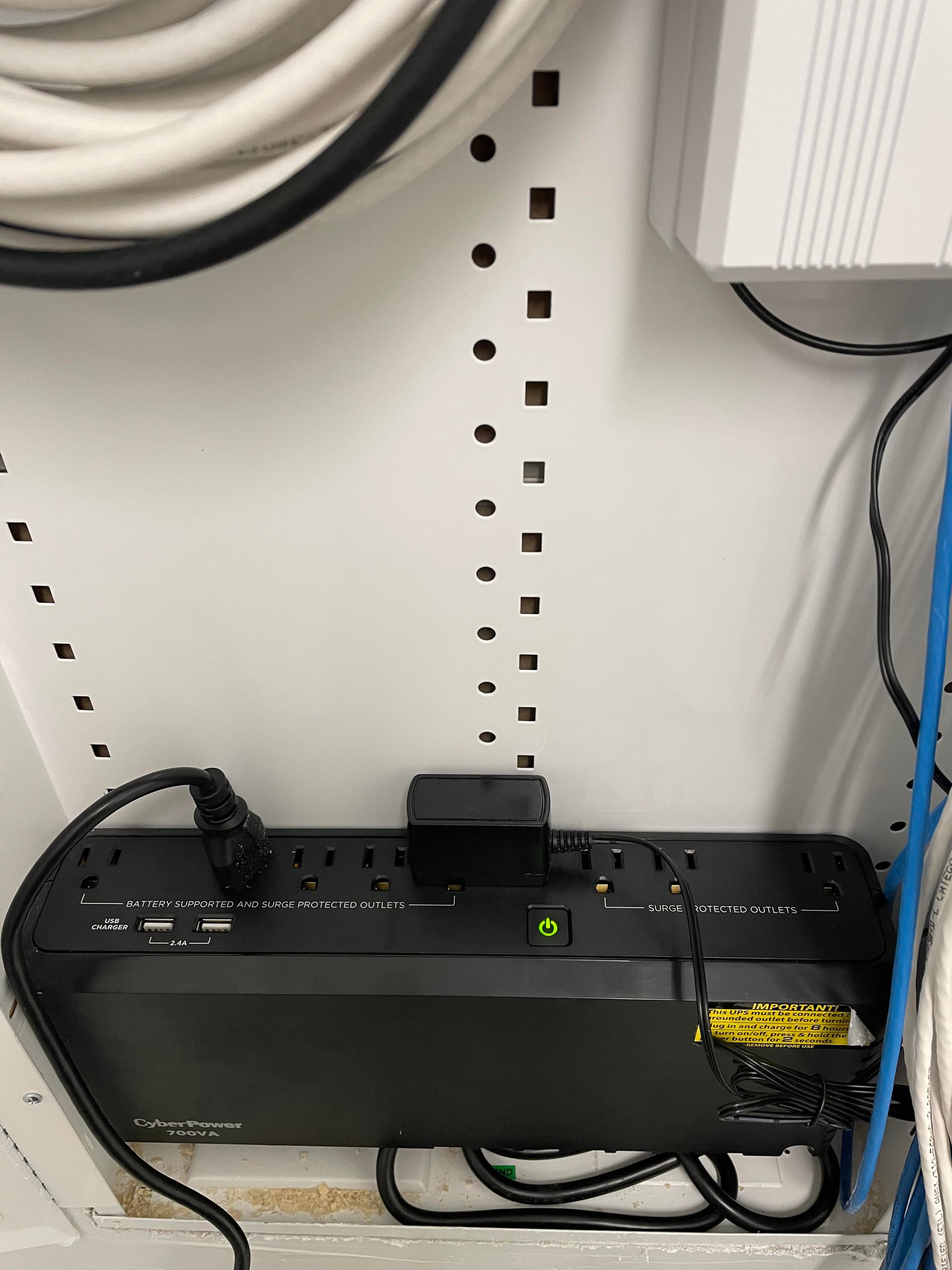

Thank you! Going to measure the now. This may work!
It fits!!! :slight_smile: Thank you! Added to cart.
In theory, both. But the protection design is the same, get excess voltage/power to ground, ultra fast). The threat from an actual EMP is the power load inducted into nearby exposed (not faraday protected) power systems/lines. But in reality, most people's threat model is a hot utility supply, maybe a really bad solar flare (50-100 year event). At night where I live, when load drops, APS can deliver nominal spikes in the 255v range, split-phase trying to scale back power supply. That's more than most home electrical hardware, especially your solar management controller, is designed to handle.

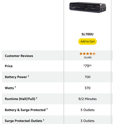

Isn't that if you're running it at max capacity? Assuming Starlink is 100W and my Flint 2 is like 10W, I feel 8-10 minutes is more than enough time for the generator to kick on unless there was just something wrong with the generator.
Sorry, forgot about the generator. With the run time I didn't think it mattered how much you were drawing.... But I could be wrong...
Oh this is just what it said. Not sure how accurate it is.
Hmmm... Perhaps I was wrong.... It does say in an FAQ section that at half load it would run for 9 mins
When sizing a UPS, the detail they tend to bury in the documentation is its Power Factor (PF) which typically is around 60% for consumer grade devices. That factors in thus. VA X PF to get what the UPS will actually support. On the Box it may say 550 VA But in in reality you can expect it to supply closer to 330 watts. There are UPS with a PF of 1 available (Eaton) but they tend to be marketed towards commercial users ie Data Centers and such.
As to time, the batteries these days will supply full power for only like 5-10 minutes. Modern electronics have switching power supplies that convert the line power into the required DC values. It is common to see one supply able to be used in global markets so they can be fed with 50Hz-60 Hz, and 100 vac to 240 vac.
Ahhh okay. So, in this screenshot of a UPS, what I really care about is comparing the Watts to the power consumption of my devices (10W for router & 100W max for Starlink dish)? At less than half of the total, I can probably expect a 9+ minute run time, which would be more than enough for the generator to kick on then? I'm about to pull the trigger on this guy mostly for its size (needs to go in an in-wall network cabinet).
Will the cabinet take the weight?
I think so? I added wooden supports at the bottom of the cabinet and if I just have it sitting like this picture, it should work

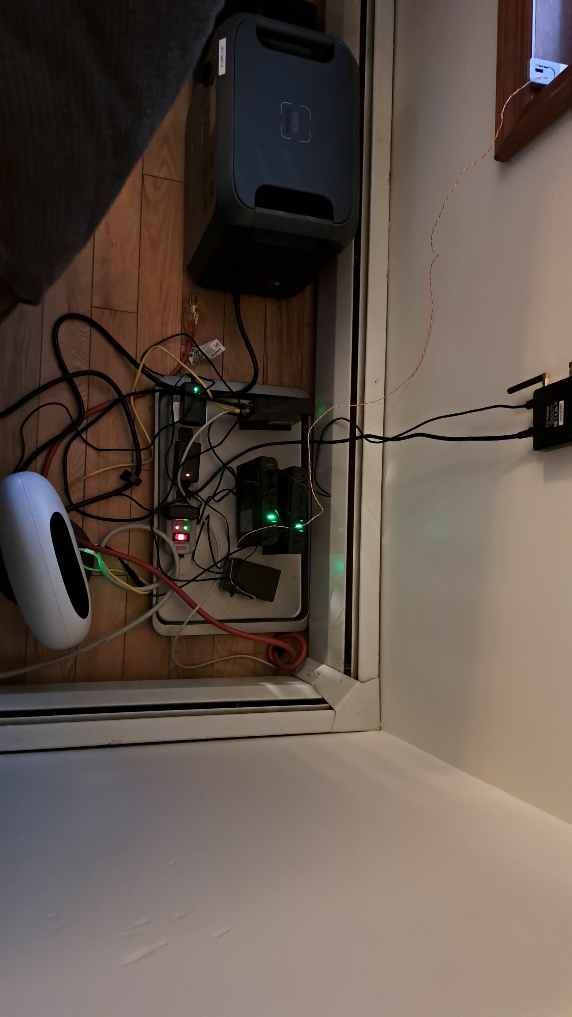

Perhaps the OP's choice with its lead acid (?) won't suffer the same fading effect? Also, perhaps won't burst into flames as the lithium's are wont to do. Hence the baking pan in the picture below, seeing as the components are on a wood floor in back of a comfy plush recliner, lol.
