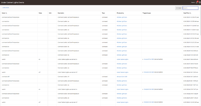

Logs do not necessarily tell you if a device was sent a command. To say that for sure, you will need to look at the contents under the "Events" button on the device detail page for this device and look specifically for entries with "command" under the "Type" column (other entries are events, which can be nice to know but are not really what you are interested in here). See the linked section of this document for more:

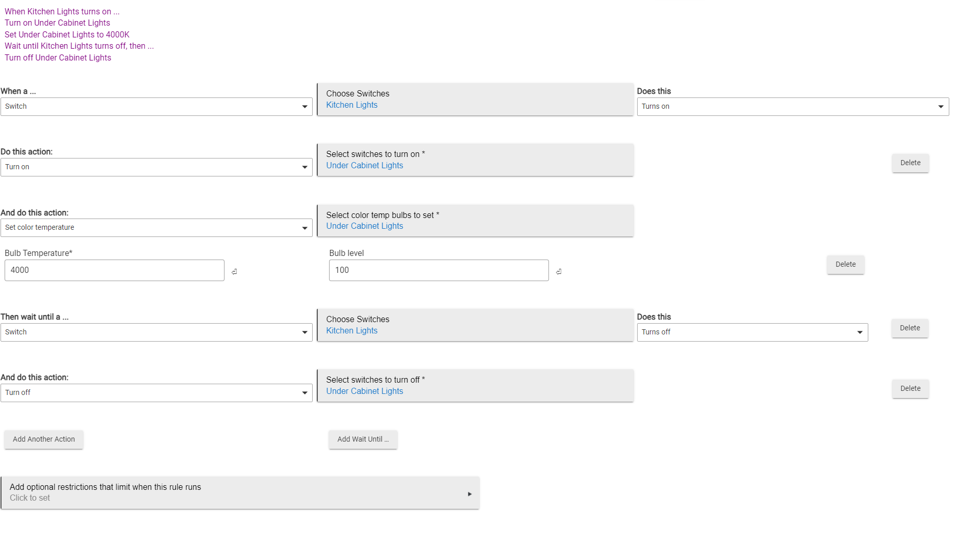

As is also suggested there, turning on all logging for this Basic Rule could also be helpful. Then, Logs will show you what the app thinks it's doing and usually why.
You might be running into a problem with restrictions in the current hub platform version, to be fixed in the next build. However, without any more information, it is not possible to say in your case.

Here's what the events look like for that device. It doesn't look like its ever getting the off command
I do have "Enable Logging" set to on in that rule i use to control the under cabinet lights.

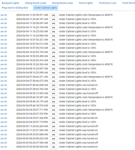

This would be the most helpful set of Logs to look at if you want to figure out what's really happening. It's possible you are affected by the bug above.
