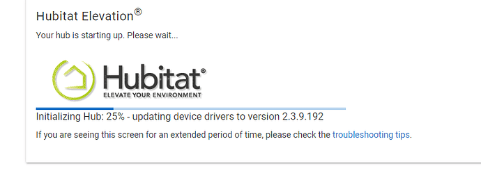

Basic C8, upgraded to latest platform and stuck at 25%.
Tried IP/:8081/ and takes me to same screen - stuck at 25%
Pulled power, waited 60 seconds, reapplied power and get back to the stuck 25%

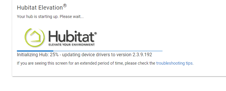

Is it still stuck on this page?
If yes, can roll it back to the previous version and PM me the hub id?

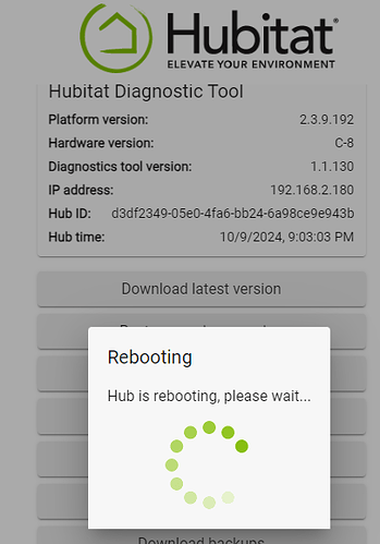

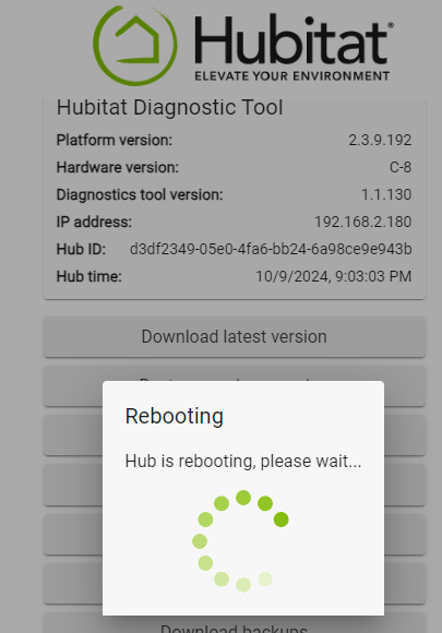

I can't roll back - stuck at 25% so no chance to connect to roll back that I know of.
Use Restore previous version menu in the diagnostics tool.
It probably rebooted. Try the normal UI or refresh the page.
Got up this norning and c8 is running! No time to tinker with it now, but happy to see it running and in the mesh. Thanks for the hand holding. This group is such an invaluable resource.
