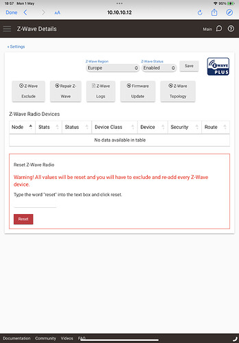

I have 23 zwave devices, 19 mains powered 4 battery.
Updated the fw and noticed the mains devices complaining about loss of connection.
Devices
Tried rebooting HE.
Devices still unresponsive.
Any ideas on how to get them back?

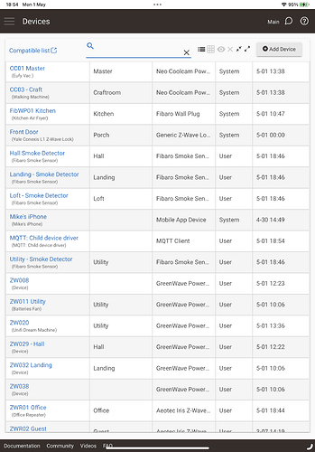

Devices
Tried rebooting HE.
Settings>Shutdown
When LED goes red, pull power from hub (at wall if you can reach it)
Wait 2m
Plug in again and let hub boot up...devices should re-appear - let us know the result.
Also - you have a Z-Wave radio FW update that you should appy:
After you reboot and (presumably) your devices re-appear, you will want to apply that update, has improvements.
