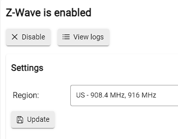

Need a little help updating my z-wave radio ..
if I goto : http://my.hub/hub/zwaveInfo < I see this ..
But when I click the update button nothing happens .. tried 3-6 times .. and different browser's.
anyway to do this different then using the update button ?
Also .. WHY would I want / need to update anyway ? LOL
You've fallen into the trap that many of us have. Me included. :blush:
That update button is if you change the region you are in. Different regions use different frequencies.
Yep. Man, they really need to rename that button.
LOL .. FFS Ok thanks .. Yeah they really do ! :slight_smile:
