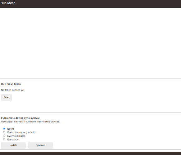

This has happened temporarily after updating (for twenty minutes or so), but now it seems stuck since last night.
Since updating one of my three meshed hubs is offline. I've tried rebooting them all, refreshing on the mesh page, I can't get it back. This isn't fun please help.
I may be having a similar issue that I'm waiting for support to get back to me on. All I know is that it was apparently obvious what had caused it. Have you tried disabling scheduled full mesh sync from the hub mesh page? Then reboot the offline hub.
I will try now, thank you.
