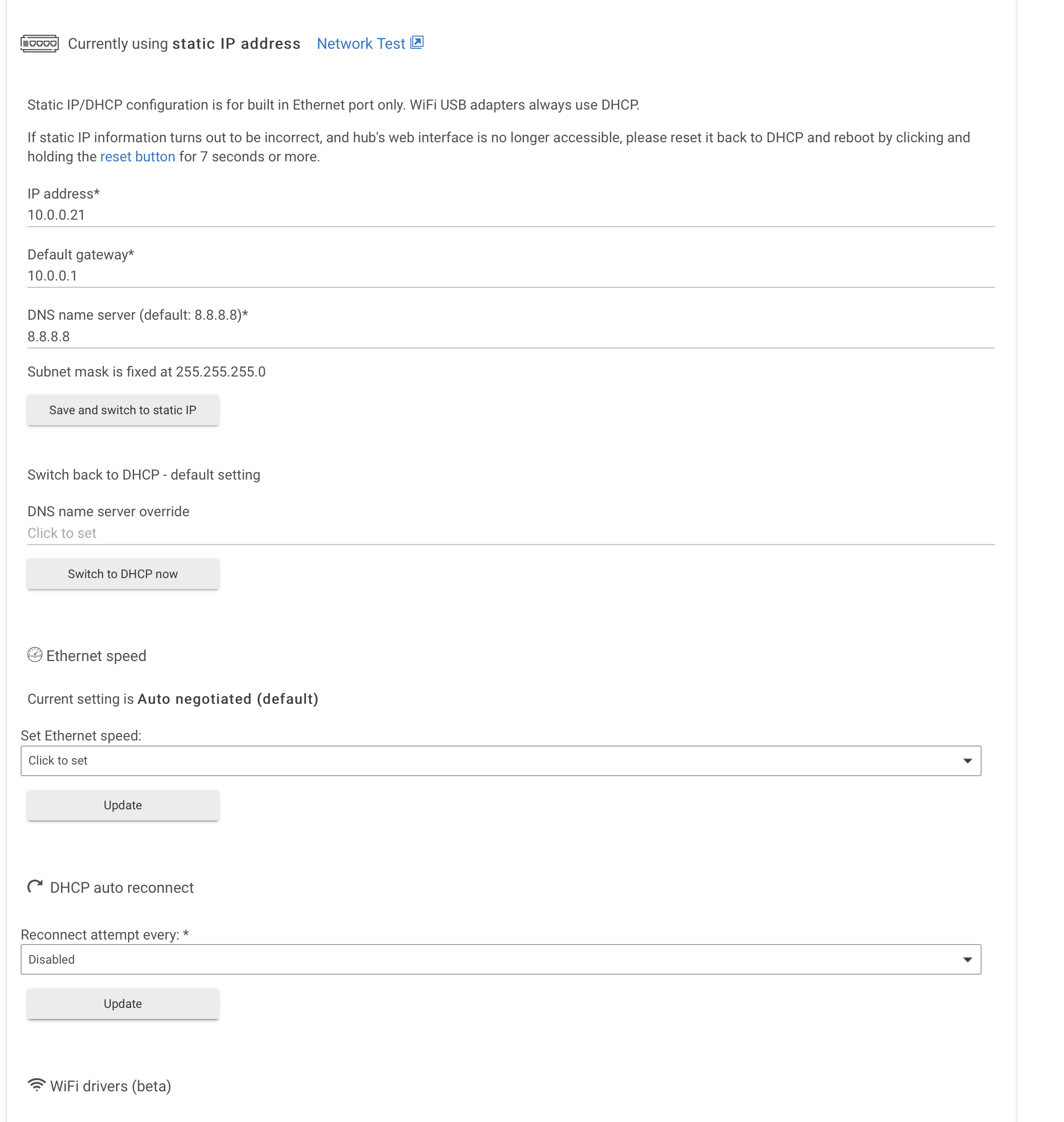

These are my current settings. It looks like resetting the Hubitat didn't change them. But I just wanted to ask one thing - I have Hubitat's IP address reserved in my Xfinity router and i have it assigned in Hubitat also. Is that not the correct way to do it? Ever since I did this I haven't had any more problems with Hubitat grabbing a new IP address (used to happen all the time and was very annoying).
I would just do it in the router and leave the hub at dhcp. That's the most reliable way. I see this all the time
