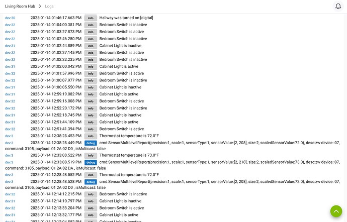

Next time this happens, can you post a screenshot of the (past) logs?

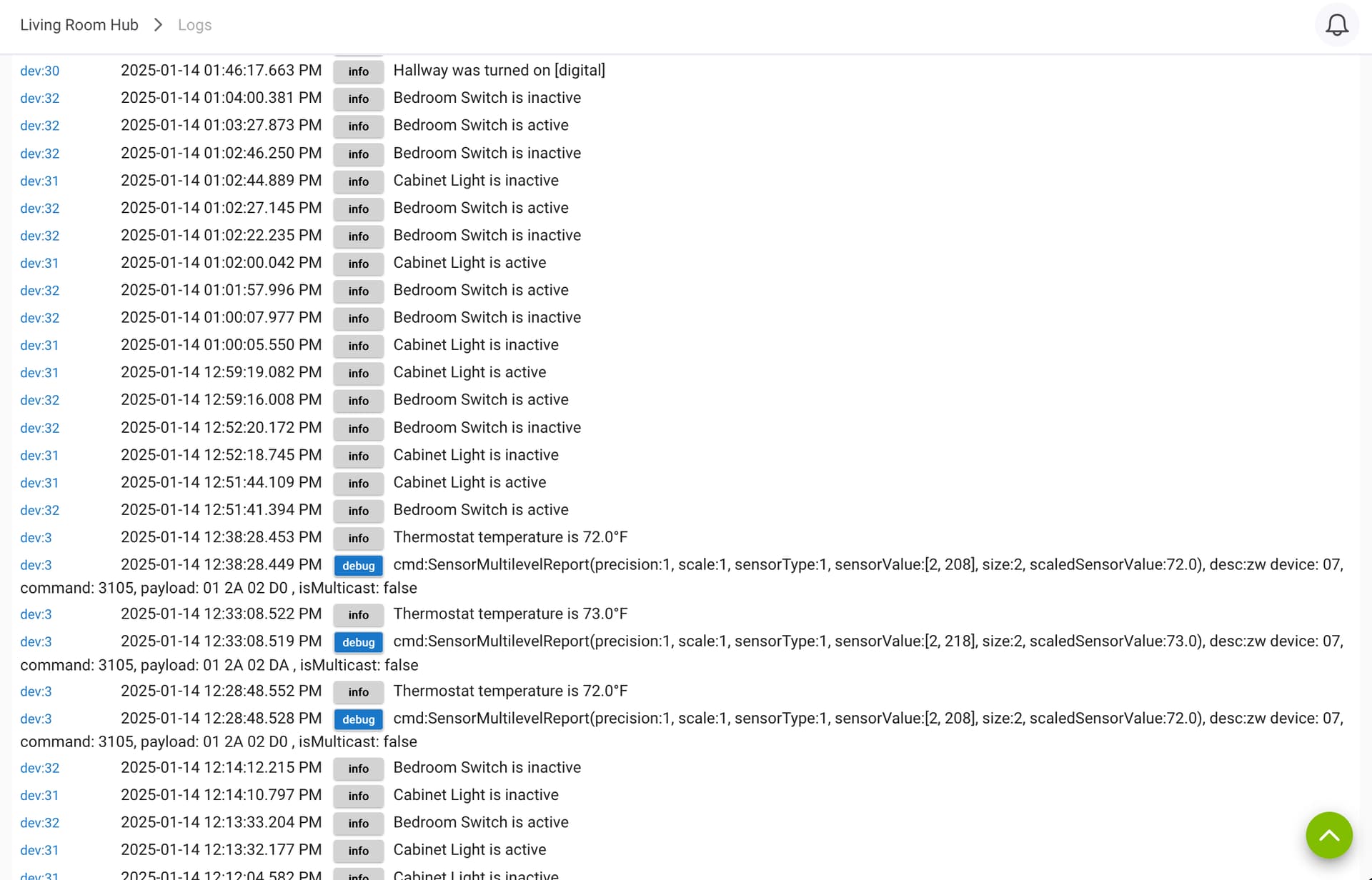

See the logs leading up to me reviving it. The event at 1:46 was me telling Alexa to turn on the switch (Hallway). It was unresponsive the ~45 min before then.
