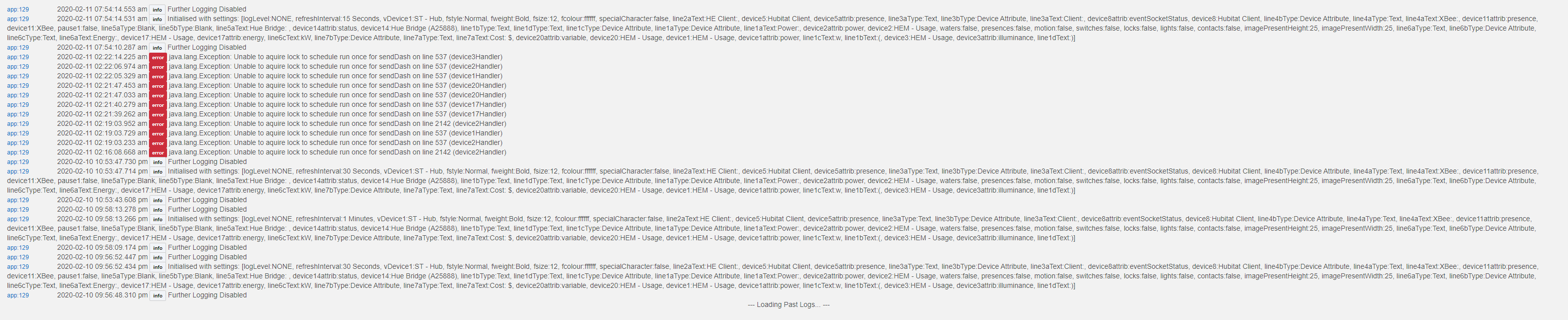

I'm getting this unknown new error. It's occurred 2 nights in a row now.
App129 takes me to the SuperTile display that is and has been working fine.

This doesn't look like a supertile error
This look more like a resources error because the code is telling the hub to run something but the hub is unable to set the schedule
Have you tried a reboot?
Yes. Hub reboots every morning. I don't think it's a super tile error either however it's all I've got at the moment.

Getting these errors every night. It seems to be All handler, which I obviously cant see/edit. The errors dont appear except for these times in the very early morning.
Edit: I reboot every night, and recently, did a soft-reset.
Please show the app throwing the errors.
It just shows "hub".
App129 is SuperTile, but @Cobra above said it's not a Supertile error.
Not an issue for an app to throw an error? OK then.
Well thats not very helpful. I'm just trying to get it fixed.

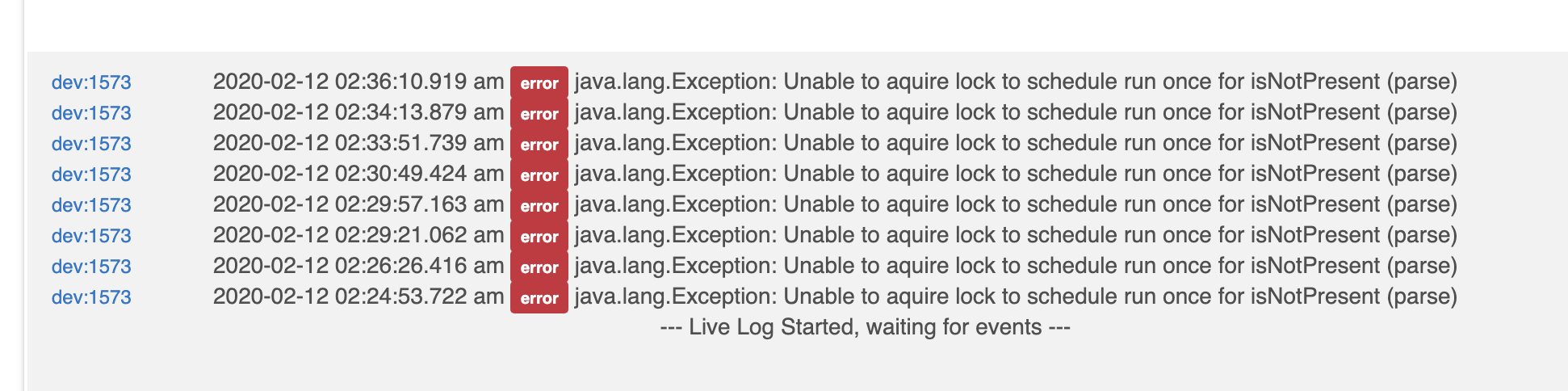

I am starting to see this error too for an ST presense sensor and a zigbee plug.
I am getting the same java exception error as cuboy29 "unable to acquire lock to schedule...." . Mine is just for Smartthings presence fobs though.

These errors are from the devices, not an app right?
All these error, including the one from my app, appear to be related to the 'runIn' command
@mike I can sort of attribute yours to being the hub being busy during the backup windows (if then is when it happens) so cannot get a lock to run runIn
I suspect that the driver is having a similar issue as it's about the same time.
Andy
Yes sir.. not coming from app that I can tell from the log.
They all seem to be from the backup window. All of @cuboy29 errors are within that period. See Unknown new error
It's a weird one.
interesting.. thanks for pointing that out. Seems like the nightly backup is doing something to the HUB to cause this.
