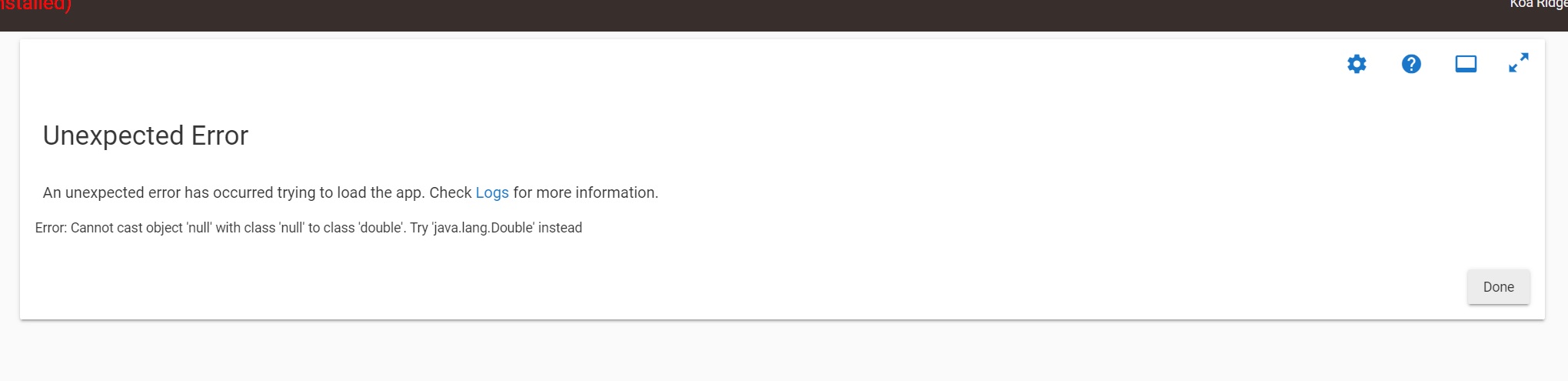

If I'm creating a rule action and choose "Set Dimmers and Bulbs" then "Set color per mode", if I pick the color as "Custom HSB color" I always get this error:
When I click the Done option on the error page, the rule is pretty much unsalvageable. Any attempt to add a new action brings me back to the error page. I'm forced to delete the rule and start again.

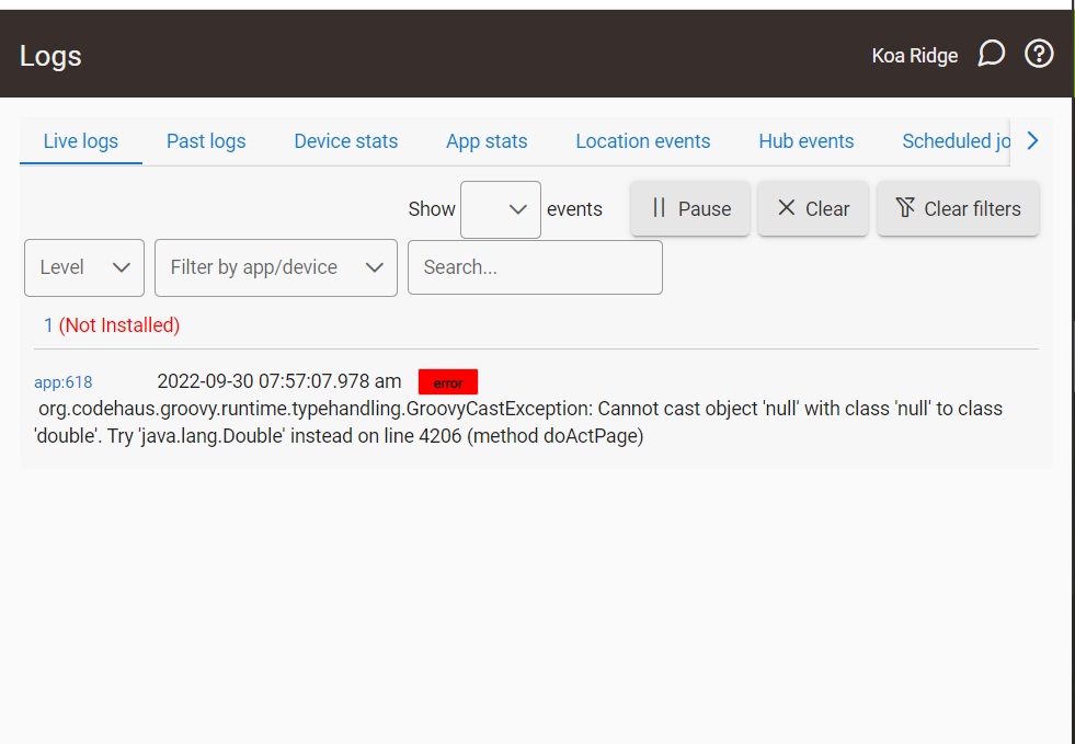

Please show screenshots of the logs, and the rule itself.
Sorry, how would I do that? I can't complete the rule. It crashes when I'm attempting to set the action and does not let me add further actions.
Then show a screenshot of the logs when it crashes.
Here is the rule right before I select "Custom HSB Color" in the "Bulb color for DAY" drop down:
Here is the log:
What release are you on?
Never mind. I found the problem. Will get a fix for that in the next release. Sorry for the aggravation.

But I'm still getting the same error on 2.3.3.128
I get this when creating new rules with "Color per mode > Custom HSB Color" or modifying existing ones.
Oh my, sorry about that. This is a different bug along the same lines as the last one, that I missed. Will be fixed in next release.
