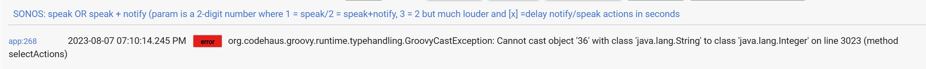

Here's a bit more detail from a recent trigger:

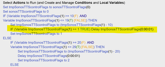

My best guess at the pasted line is highlighted (as best I recall; 90+% certainty):

Next step is to delete that action, and add it back without using copy/paste. See if that works.

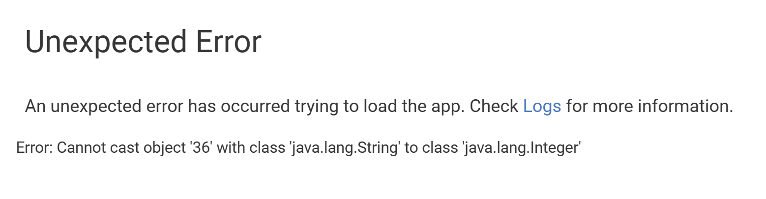

LOL... obviously, I would've done that if I could. :slight_smile: I'm unable to get into the Actions editor, doing so triggers the errors I pasted. Is there another way to edit Actions, perhaps a command-line interface I'm unaware of?

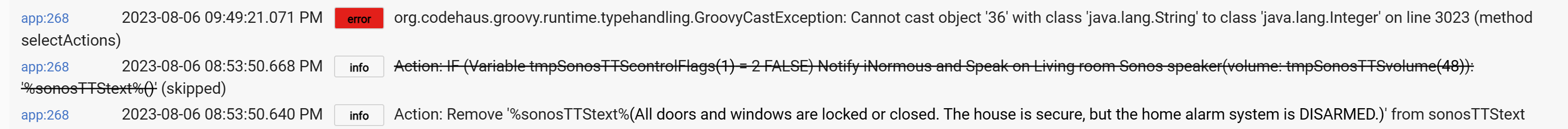

The error you posted above is from the rule running, correct? What about an error in the logs when you try to open the rule?
Here you go.
And actually, I think I was wrong earlier--the error I posted before appears to also have been caused by me trying to enter the Actions editor (the Sonos speaker was relaying a lightning warning at the same time hence... unless the error returned is the same which seems unlikely).
