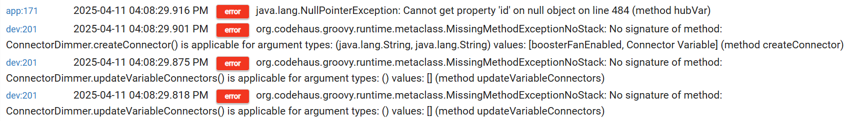

I have a C8 hub running platform 2.4.1.157 and have a problem with hub variables. I think I was trying to create a connector but I must have screwed something up! If I now select Hub Variables on the settings page I get a message saying "Unexpected Error" and the logs show the following.
How do I clear this? I should say I have asked Hubitat but they have not responded
Do you have any (other) hub variable connectors? If not, there is an easy fix. There's also an easy fix if you do have any but aren't using them in any apps. Anything else is probably going to need you to restore a hub backup from before the time when this started happening or for a specific staff member to see if there is a magic fix. If you just made this change before posting, the hub makes daily early-morning backups by default and should be easy to restore.

I think I have a few hub variables (can't see them now) but only one connector that is used in a couple of apps. It is no issue to remove that connector from those apps and add it back later. Unfortunately this issue is quite old now and I've made a number of updates since then, prefer not to dig through my backups!

Guessed the easy fix was to delete the variable from any apps and then delete the connector device. Did that and all is good now. Many thanks!

That's actually easier than the solution I was thinking (though you probably didn't need to delete the actual variable) -- but with only one, it's probably not that different either way. Glad you got something figured out!

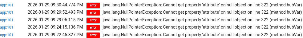

I have the same problem, I setup a hub variable and was working wis webCoRE and now I cannot get into the section hub variable anymore. I get an unexpected error message and and the error messages in the log
I don't know what I did wrong and how I can fix this
I have more than one hub variables and connectors. Please help........

Your error looks different. Unless I'm missing something from your description, I don't see an error on (or near) line 322 mentioned anywhere above, just line 484.
For your problem (line 322), I do have any idea. Were you trying to rename a variable and something went wrong? If so, can you remember what the steps were to reproduce that? (This error shouldn't happen unless you had started a rename.)
