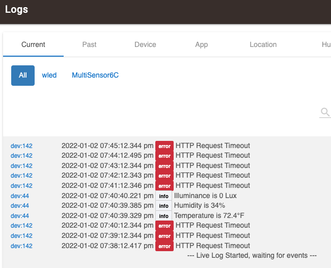

Here's my logs on one of my hubs in the past few minutes...
Counterintuitively, I can say that everything is working perfectly :smiley:
Those errors are for a device I have powered off at this moment and the hub is just informing me that it noticed :slight_smile:
Thus interpreting the logs is context dependent in a very large way.
