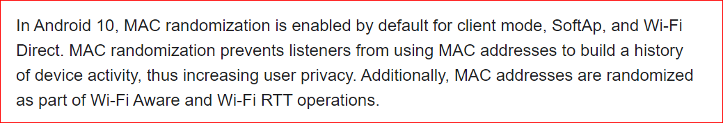

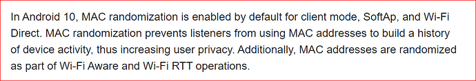

Which also means mac randomization needs to be turned off on newer phones, too.

@JasonJoel
(to be frank, I didn't know this was going on):
I use (as many do) the registration of a certain mac address to a certain ip address to indicate presence. It's probably my most reliable indicator. I'm going to have to turn it off, or figure something else out.
In checking this out, I find that this particular switch varies by network - i.e. I can turn it off only for my home network, and not for any other. That might allow me to continue using the existing program to track presence.
Turn it off, that's what I do on my personal/family devices - for this exact reason. Although I don't use phone mac/ip for presence detection, I do use mac/ip for firewall and content filtering rules.
