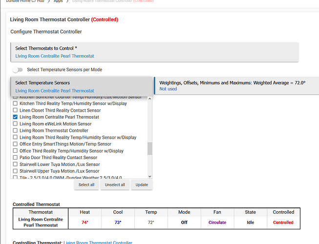

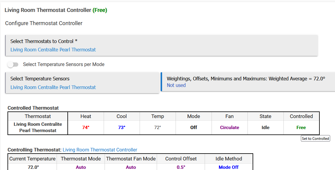

First, does your screen look like mine? obviously the drop down on your will show your available temp sensors ..
For me, the function of switching from Controlled to Free is done in the Controlled Thermostat block - the actual word in Red above. Its absolutely not obvious! The word itself is actually active as a switch - when I click mine the word changes to Free in green.
If you already knew this, then my apologies.

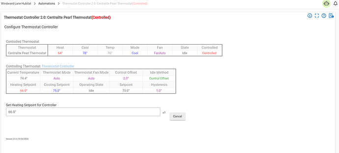

No, my display appears like this:
As you can see, the “Controlled” bit is greyed out (I know that’s where I USED to be able to switch it between free and controlled). This all happened after an update to the software. I sure didn’t expect this stuff to go dormant! Sheesh!
You're in the middle of setting the heating setpoint in that screenshot, which (since you didn't mention this was intentional) I'm assuming is the problem you describe. Hit "Cancel" to get out of that, then you should be able to do do other tasks in the table -- including what you want -- again.
Well, I’ll be damned! That was it! As soon as I hit “Cancel” in the heat setpoint, everything showed up as expected and I could add the new sensor.
This thing has a monster state machine in it. Keeping track of half-finished tasks is something I didn’t expect!
Thank you bertabcd1234! All is well now. And excuse my utter stupidity!
