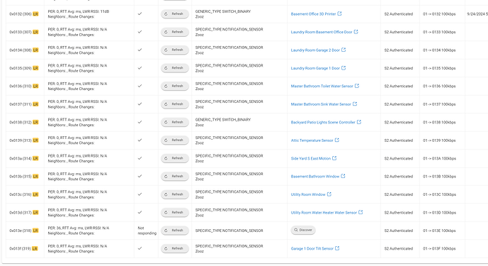

Anyway, after a few days of both ZSE43 sensors performing poorly, I'm ready to remove them and just go back to my working Ecolinks. I pressed Delete on the device page, got a pop up that I failed to read before clicking through. Now the device is gone from the Hubitat device list but still lives on the Zwave page. I can click REFRESH or DISCOVER. No amount of refreshing will give me a DELETE button. I have tried about 30 times. I've also rebooted the hub. What to do, I want these off the zwave list.

That is an important popup. :slight_smile: It would have said to put your device in exclusion mode, then it likely would have done a proper exclusion, removing itself from both you hub's device list and the Z-Wave Details table. It would also warn you if any apps are using the device so you can remove it from them first, avoiding the possibility of breaking any of those apps. Finally, if the exclusion did not succeed after some time, the text would change and offer you a force remove instead. This removes it from your hub's devices list but not the Z-Wave radio (the Z-Wave Details table) and is generally preferable to avoid. You should still be able to clean things up manually as you are now, however.
As for why that isn't working, what you're trying should work. But battery devices might be more stubborn since it's normal for them to not check in. You can remove the battery for now to be extra sure that it doesn't, but coming back and trying again later may reveal the Remove button already there or that it works again if you try a Refresh and then Remove.
You could also start a general exclusion from this page and put the device in exclusion mode, assuming you haven't already reset it (or done a general exclusion with another controller). That should remove it too since the node information would still match.
