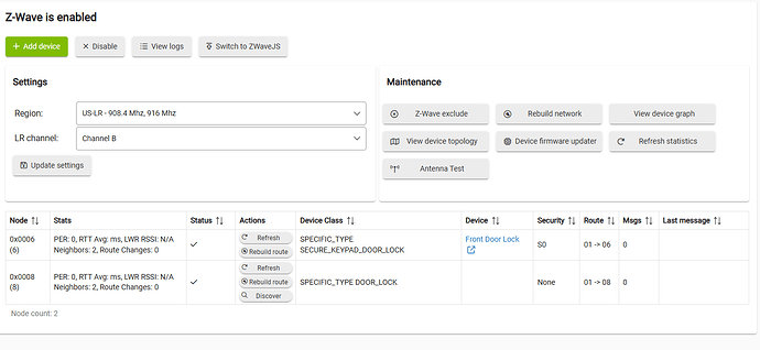

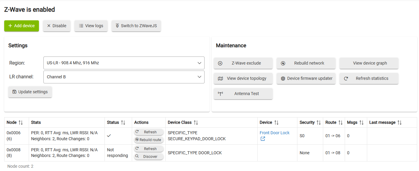

I have a kwikset connect 620 that I tried to add to my hub and it failed and now I am stuck. When I did the include, it asked for the security code and I added it but it never completed successfully. So the device was red in device and I was unable to exclude. I was able to force remove thedeice but still unable to include. I have a phontom entry in my zwave that I think is messing it all up.

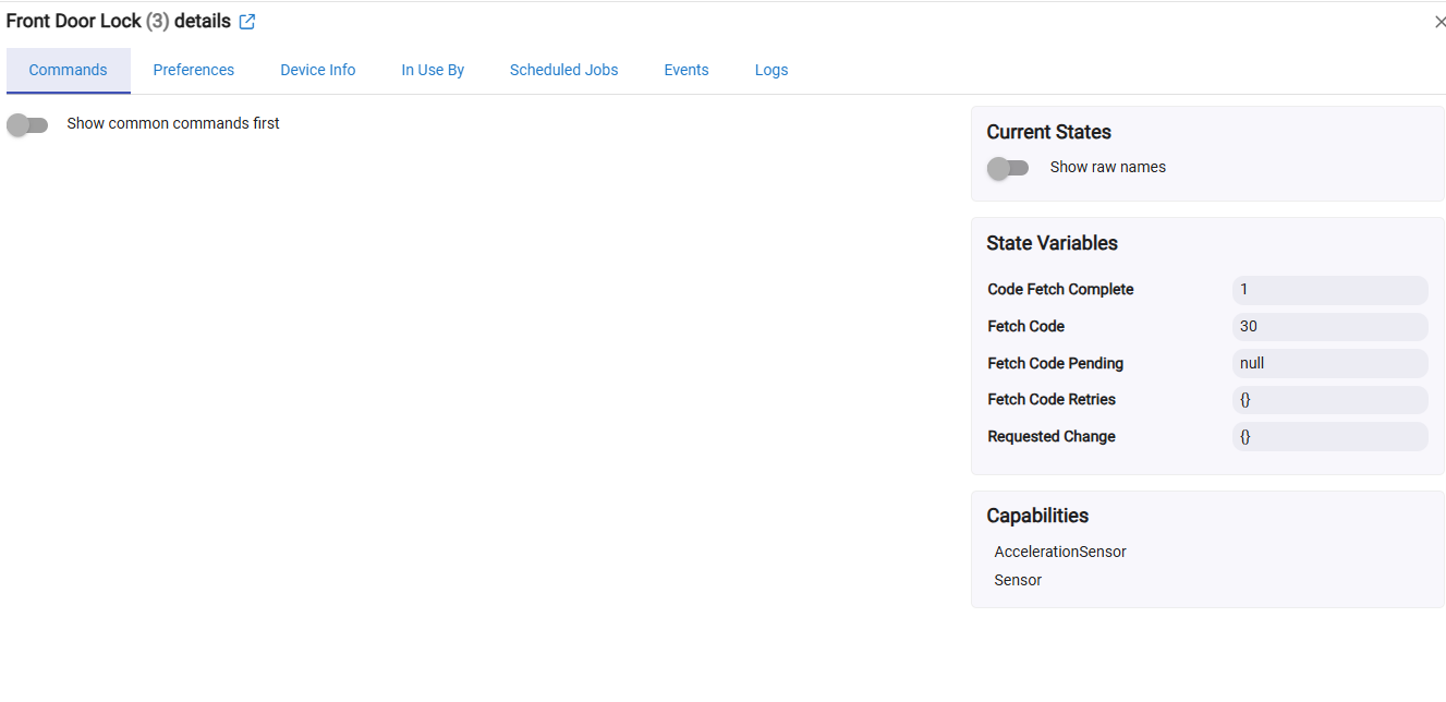

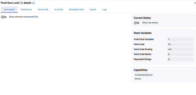

fixed front door, it changed device type on me. Still can;t get 2nd door lock working

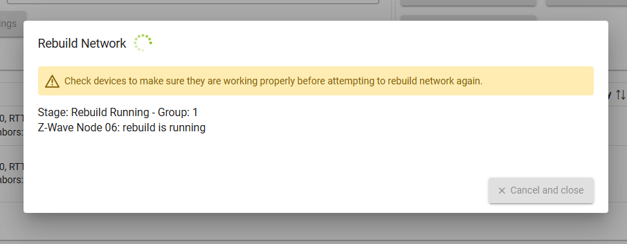

unable to rebuild network either. and now unable to do anything in z-wave settings
If you switch to Z-Wave JS you will find it is better for cleaning ghost devices. You can then switch back to Z-Wave ZIP if you prefer it.
You’ll need to do an exclude on the lock before your try to pair it again. It should all work out fine…

I moved the hub into th esame room. I just switched and trying exclusion now even though device is not in device list
the exclude worked! trying to add again
